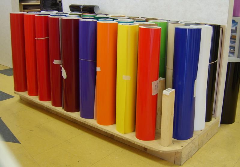

Hi There,
Here's our simple rack. It holds 40 rolls of 24" vinyl. Dimensions are 24"x60" The 2x4 uprights are 12" long but you could make them longer for 30" stock. THe plywood base is on a 2x4 frame. Hope that helps.
