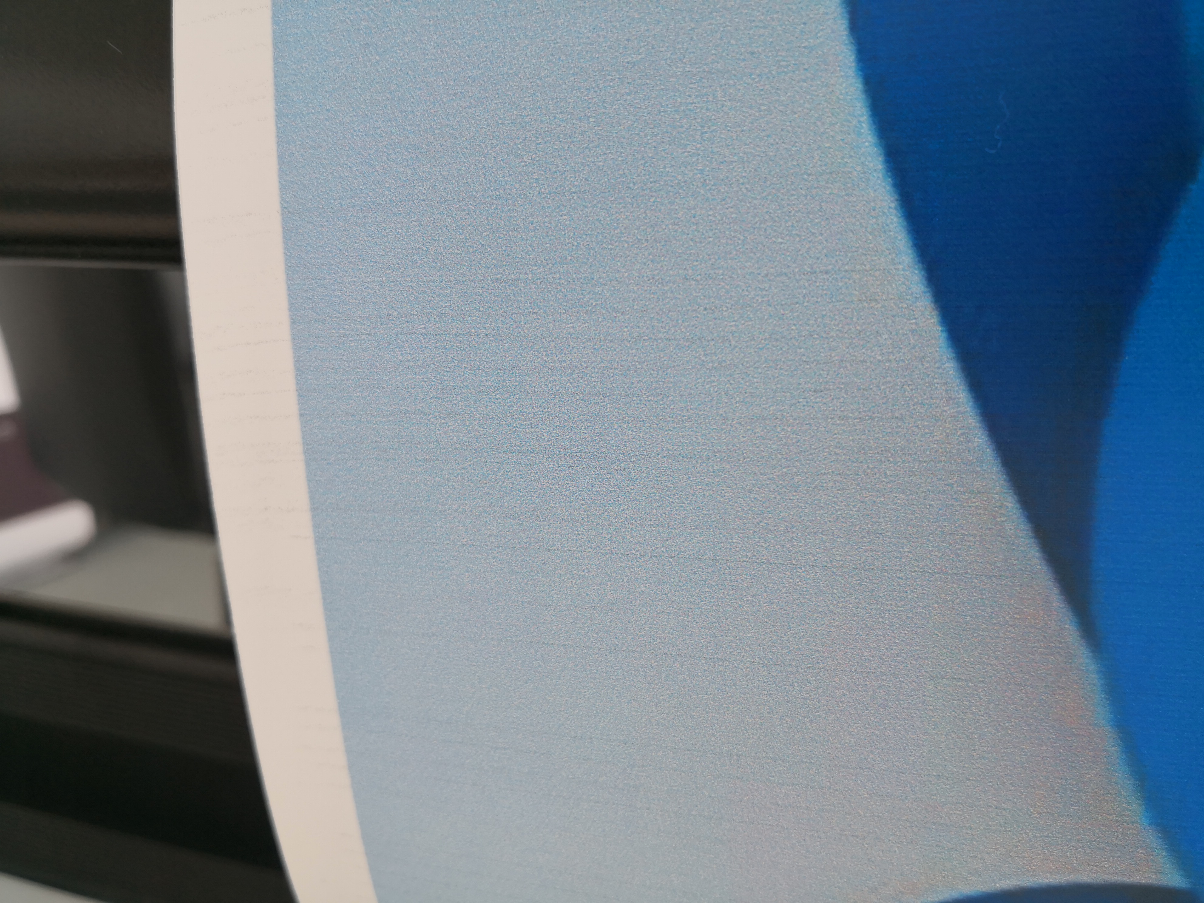

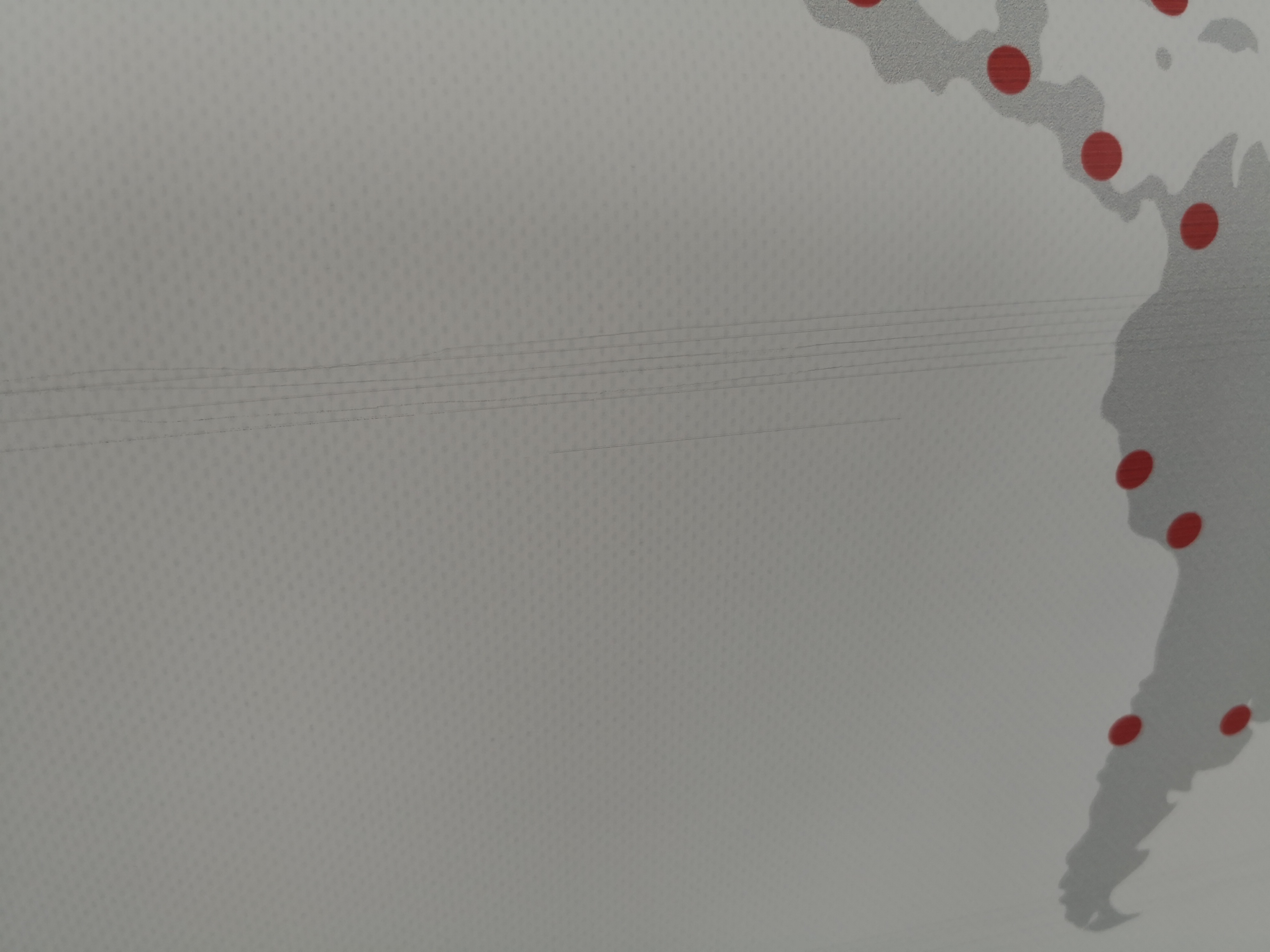

I have problems in my old Rockhopper Ii 50.
I have a horizontal black lines on printing. Don't have a pattern it is random.
I already change cap tops, pumps, wipers...
Can you help me?
Thank you

Hello.
Please help me.
The lines appear and disappear. When I print at 1440 rarely appear.
Thank you

Does it appear on bi-directional also?
Asking because mine does light marks on one-directional only, not on bi-dir.
Only visible on blank areas.
Maybe the printheads just are on the end of their lifespan.
