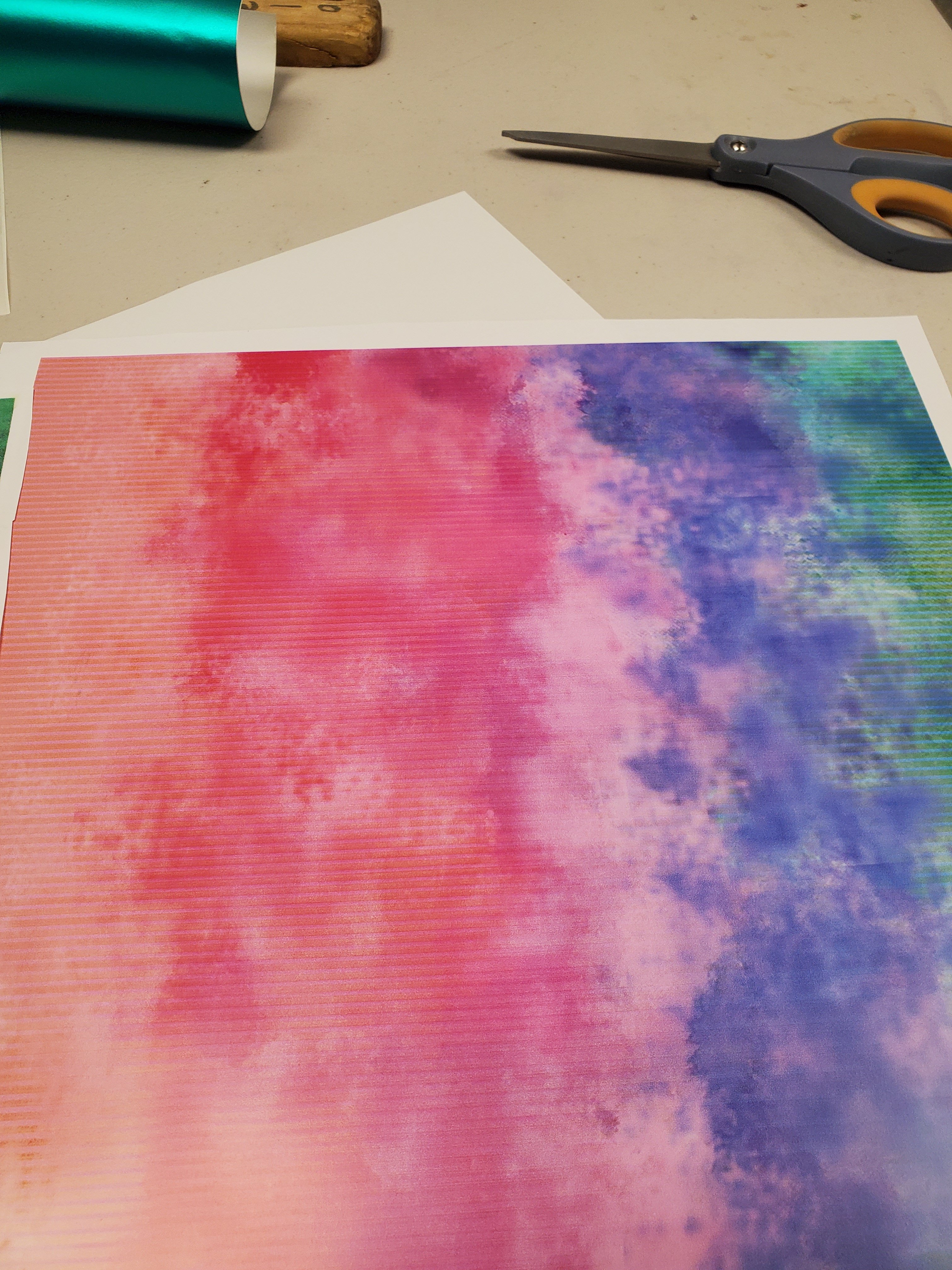

I'm a newbie to the printing world. I purchased an HP l25500 to give us a feel as to if we should commit to having a wide format printer. The machine works fine but for some reason I'm getting horizontal banding on my prints. I did a few print head cleanings, and it has helped but I think I should buy new print heads. The current ones sat for a while in storage, so Im guessing thats the issue. I attached photos as a reference. 20200908_185846.jpg

Yeap, blocked printhead nozzles. If I remember correctly you should be able to print a nozzle map from the cleaning or other menu? Can't remember how it was on these old ones anymore.
You can take them out and give them a waterbath (on the nozzles), then wipe them on a smooth rag. Do that 5-10 times and just let the water sit on the nozzles for a while with wet rag. Should help to recover nozzles if the PHs still have life left in them.

I hope it was just about free, or they paid you to take it.
Parts are going to be super-scarce, unless you scrounge two spares to be sacrificial donors, and get extra stock of heads and inks and head cleaning cartridges and ink waste buckets.
PS It looks line new heads are in order
Do a head test print (from the console) and it'll show you which of the 6 are not working and by how much.

Thank you. I have a few (new in package ones) I'm going to swap out. The ones I dont have extra heads for, I will definitely do a cleaning.
I found a few places online that still carry product. (Grateful). This is not your average desktop printer so Im definitely learning as I go. :) Thanks so much for your response.
