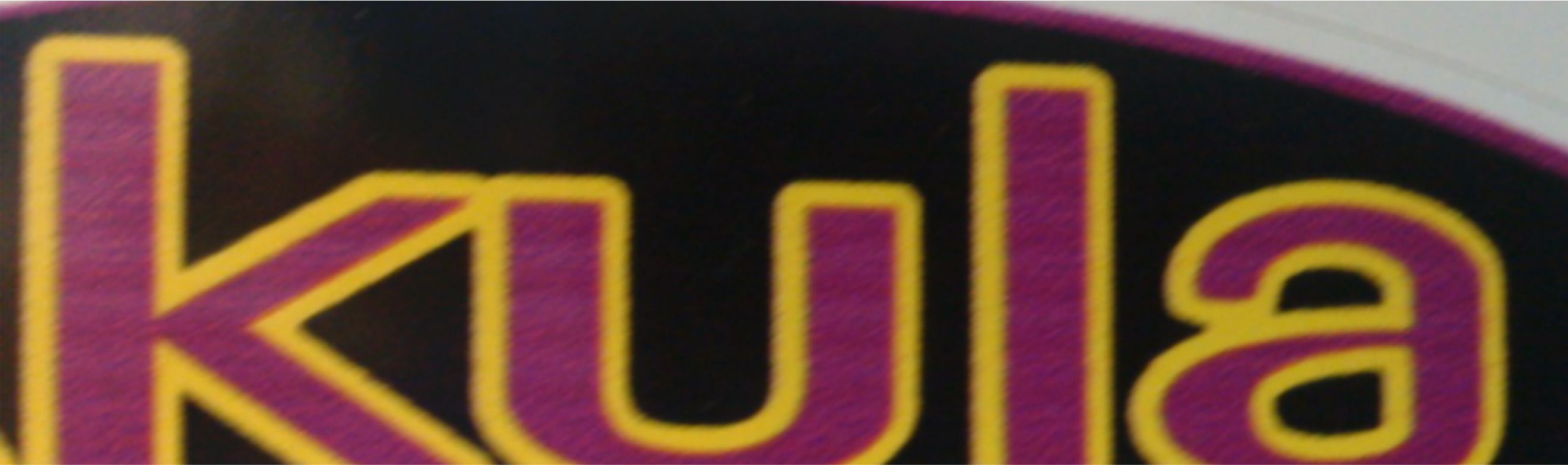

Created test art using a pen outline on one and a vector outline on the other.
Vector outline is better, slightly off but better.

Glossy calendared

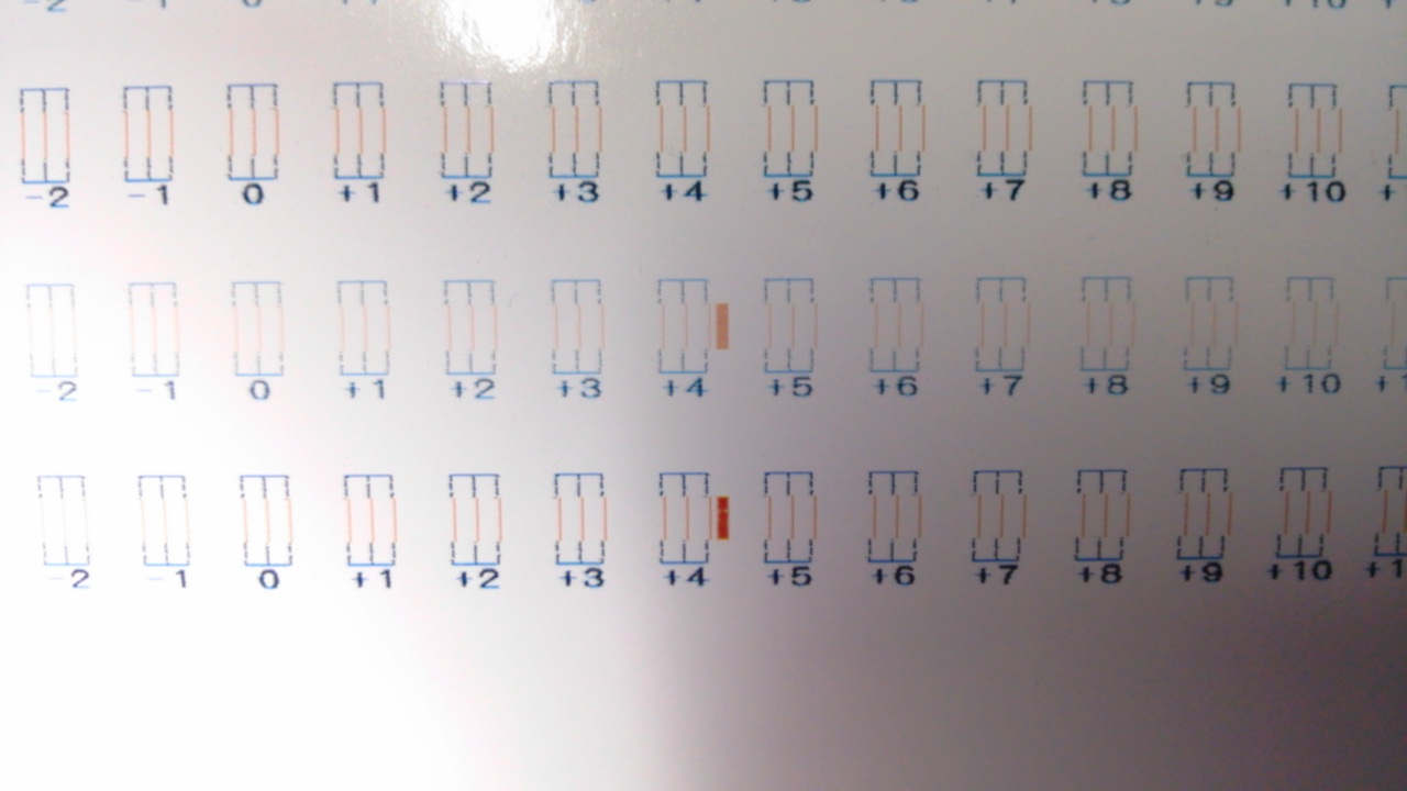

Vertical, bias (mechanical) and horizontal (most likely here I think) calibrations, which are in the service mode.
Trickstar
Off just a tad.
