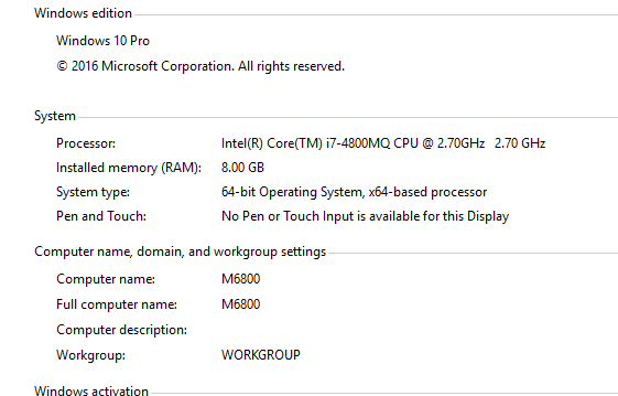

I have Horrible slow issues rendering drop shadow through effect stylize.
Is this just me or everyone?
I will try at work tomorrow and see if i get the same results.

oksigns
so that 4800MQ tells me your designing on a <laptop>[so these forums auto link to ads now?].
2.7ghz is paltry at best and I'm assuming you are using the integrated GPU on that CPU. If that is the case, that is your explanation why things render slowly. If you have a discrete GPU, then it probably is not supported by Adobe to render within their programs.
