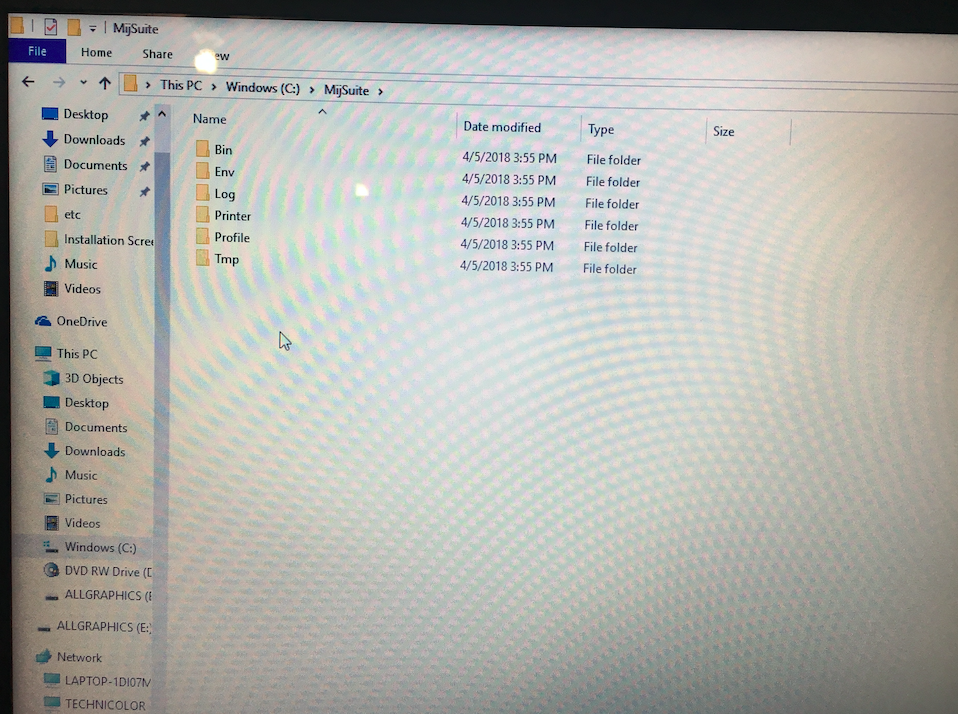

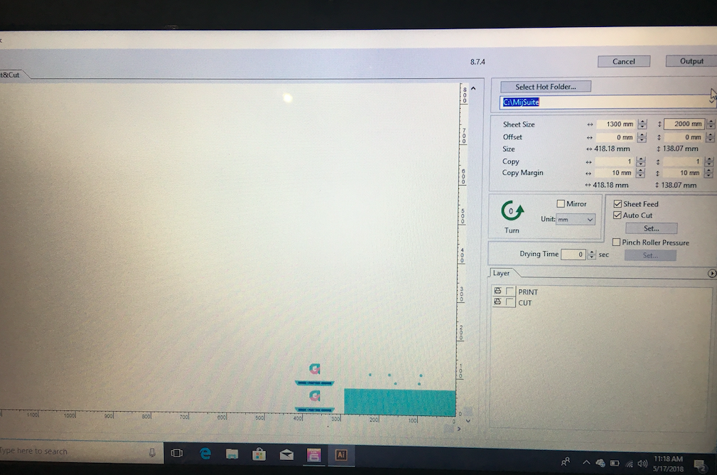

Hello guys. I have a mimaki cjv150 running with rasterlink pro 5, the problem is that i unistall the rasterlink and re install it but now when i want to print and cut i open the job on illustrator and sent it to rasterlink but in rasterlink it tells me that i need to choose s hot folder. I go to MJSUITE folder where i use to have my hot folder but it isnt there. How can i create a hot folder? I'll appreciate your help! William

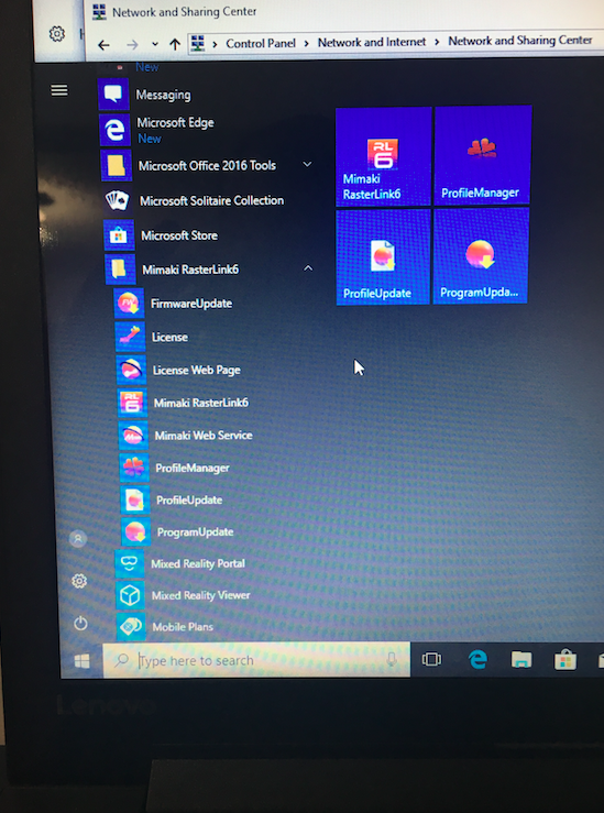

Here is the rasterlink folder photo, thats all it have inside.
Solventinkjet
DIY Printer Fixing Guide
Oh ok it looks like you have Rasterlink 6 already! In 6 you open the main program and then it should just pop up and ask you to setup a printer.

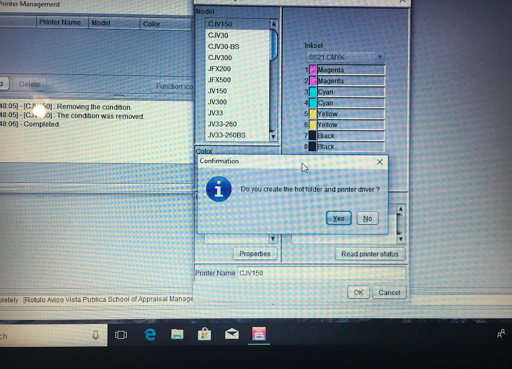

Ok, i find the print management in rasterlink, i delete the printer and add it again and this is what it shows.
Solventinkjet
That should do it. If it fails to create the hot folder after clicking yes it will tell you. If it does fail it means you need to download the latest version of the installer from Mimaki. Older ones glitch out for some reason.
