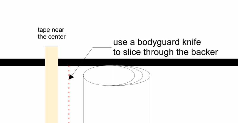

I've never done it wet, but for wide projects, I apply side ways(left to right) as opposed to top to bottom. I hang the whole thing using a series of vertical tape-offs that help subdivided the panels which is helpful if you go it alone. Light pressure at first. Precut to fit window is easiest for me.

no need to wet apply. tape down the middle then apply left to right

Window perc can turn out to be a nightmare sometimes. i had to install some window perf that was froggy juiced. The vinyl was soft as hell and the florida sun was hitting us throughout the whole install. I never had such pain installing perf never ever. I really thought im just going to trash the piece... anyway. I do the same backing paper cut with the bodyguard knife. only difference is that I do not tape up the vinyl.i cut the backing paper twice 5 inches below the top of the vinyl. Cut the paper 1 or 2 inch apart then remove the 1 or 2 inch backing paper strip. As I said do this like 5 inch away from the top so you will have a lot of liner on the bottom,your exposed strip and 5 inch liner on top. now you can position the vinyl without sticking everywhere. Once you have a good position just tack the exposed part down. then fold down the top part. remove the paper. install that piece then do the bottom.

That's a nice way to do a quick diagram. I'll have to keep this in mind for my next install. We've pretty much always done the butterfly method. Tape top & bottom in the middle, lay down one side, lay down 2nd side. But never anything that large.
