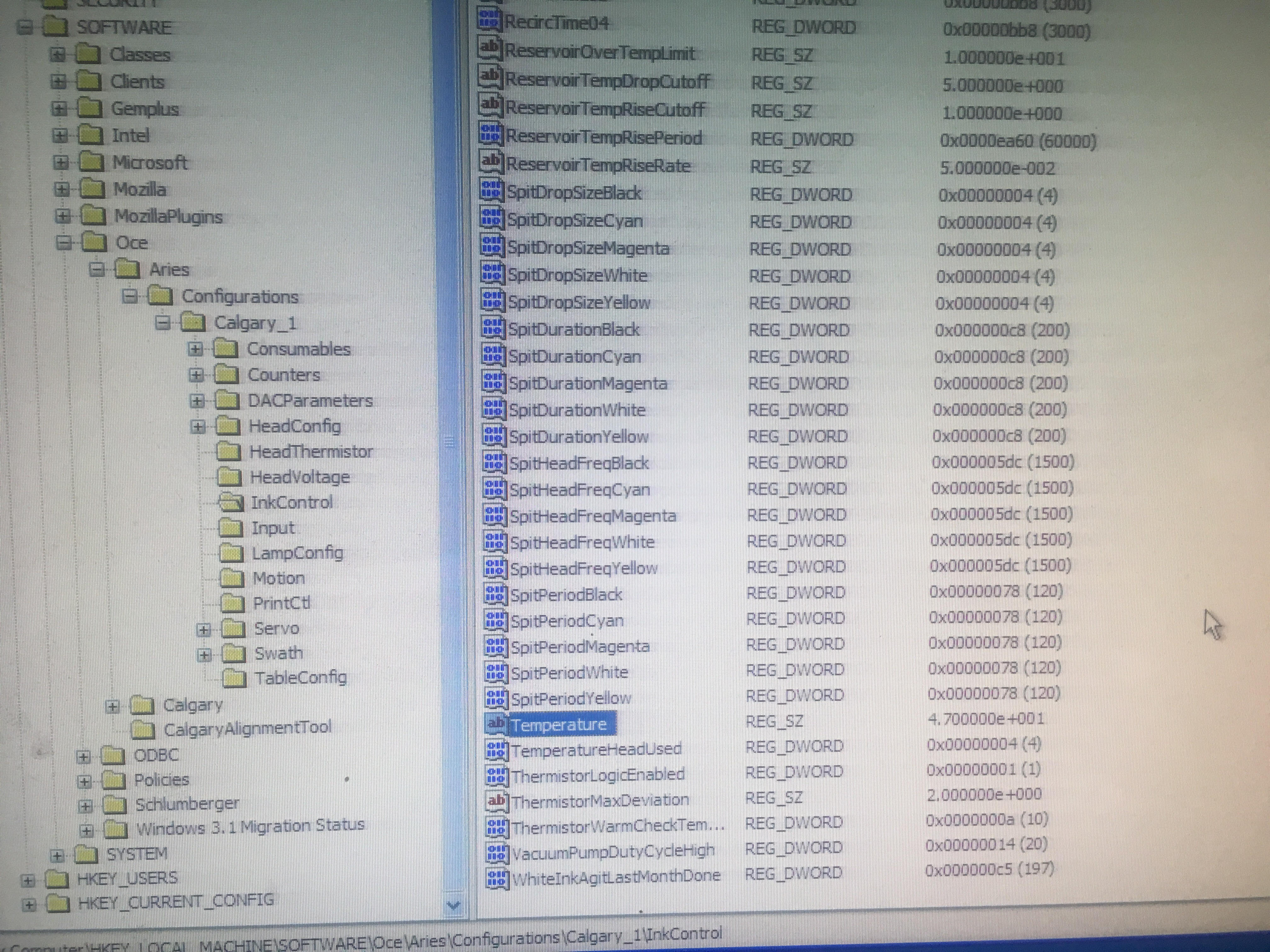

1. Close Calgary and go to Windows. (you need to connect the keyboard)
2. button start / in the line "run" enter "regedit"
3. path hkey_local_machine/software/oce/aries/configuration/calgary_1/inkcontrol
4. On the right, find the line "temperature" and change it to the desired one.
NorthControl
Yes, but be careful with reference temp. It will modificate the head voltage too. The best if you set the ref. Voltages too, and sincronise the ink type too. ...
