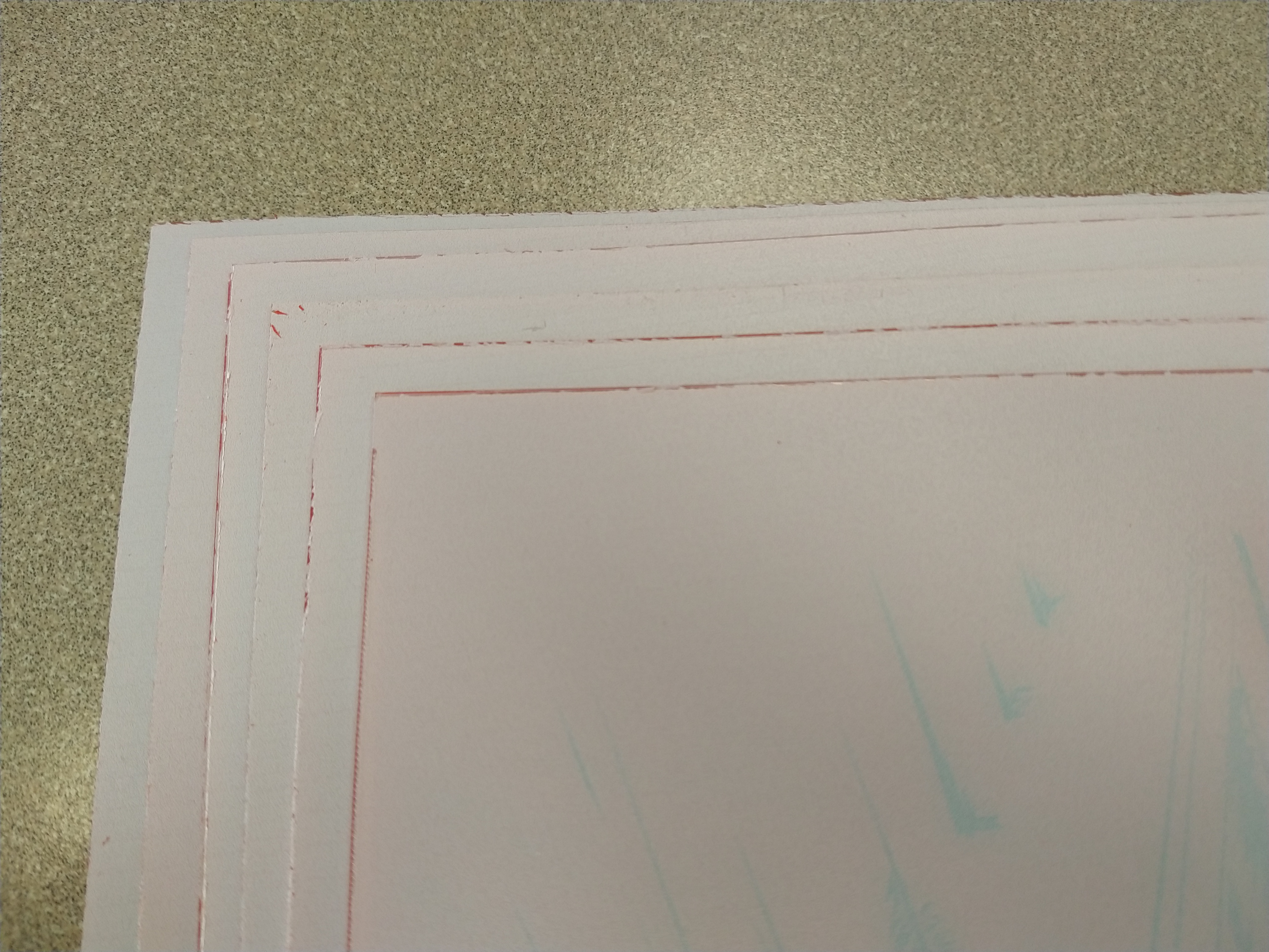

This job is requiring me to trim down the customers already printed pieces.
The ink is chipping and lifting at the trimmed edge.
These were printed at their facility - so I don't know what kind of machine or inks they are using.
We are going to let them sit over the weekend in hopes that the additional time will reduce the chipping of the ink.
These were printed on Wednesday. In my experience that should have given plenty of time to properly cure.
Does anyone have any tips or tricks for promoting UV curing after printing?
My plan was to lay them out so they can breath a bit and hopefully catch some rays from the windows in our building.
Thoughts?

I don't think you have a curing issue you have a substrate/ink compatibility issue. The ink isn't adhering to the substrate. They will need to use an adhesion promoter or different ink or different substrate. Do some testing next week on the piece that's already chipped, but I don't think you'll see any improvements.

I tested the dyne levels of the substrate and it came in around 36.
My experience is that we need our substrates to be at least 50.
We are printing on an EFI-H1625 with manufacturers ink and 50 seems to be the lowest we can go while still getting good adhesion.

Sounds like you have an ink-to-substrate adhesion issue.

Everyone is correct that this is an adhesion problem. UV ink comes off the press cured, it’s not eco solve, it will not cure or dry further. Even if you we do just run lamps on your press over it again it will do absolutely nothing.

We had this exact problem, the ink would stick fine until you cut the substrate. If you put a piece of duct tape on the ink and pulled it
up, the ink wouldn't come up... if you cut a X in the ink and use duct tape, the ink will come up.
We resolved this by switching to a newer generation ink, that was more flexible.
The only work around, is on the printers end, I was able to print the image at 25% density, and print again at 75%... that thin layer
of ink would cure and adhere much better.
