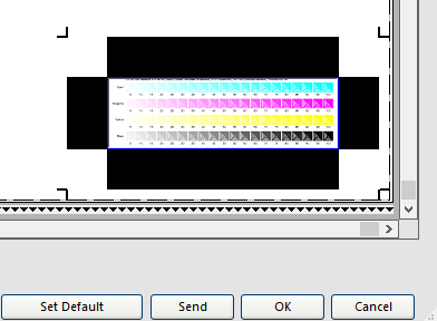

Would this be why when I add a crop marks and a bleed using PM it puts the crop marks on the edge of the bleed instead of the edge of the artwork pre-bleed? I guess contour cut marks and crop marks work the same. Maybe I've missed a setting that puts the crop within the bleed or maybe my brain just isn't working and I'm trying to do something stupid but seems to me like this should work how I intend.
The black below is my bleed without corners just as a sample.

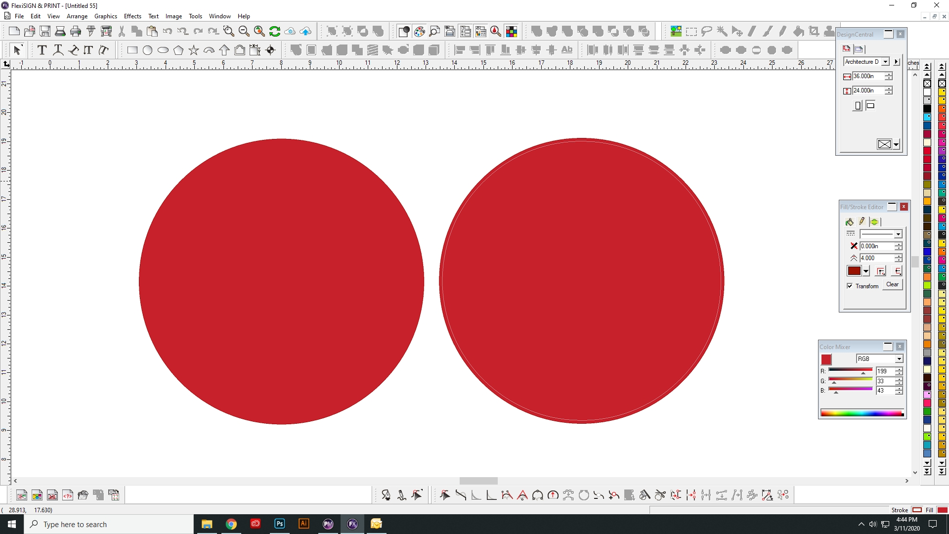

eahicks
No. Forget about bleed period in Production Manager. You build your bleed in the design. See attached....red circle. Then contour added, red has small bleed.

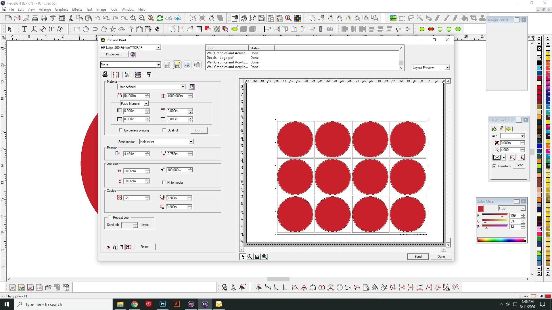

eahicks
THEN when you RIP it sets the reg marks (summa in my case) and then set quantity. Done.
