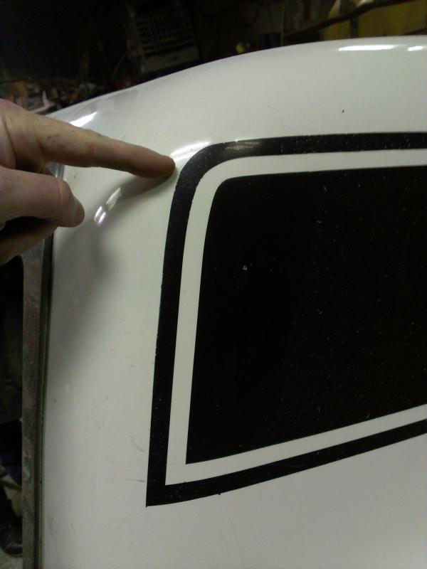

How do i reproduce this in flexi?
anothersign
I need a rectangle with 1/2 inch outline but i need 3 corners square and one corner rounded and i am drawing a blank...any ideas how i do this?
These were painted on this hood and the hood was busted in an accident so i repaired and repainted the hood and need to replace the stripes with vinyl.

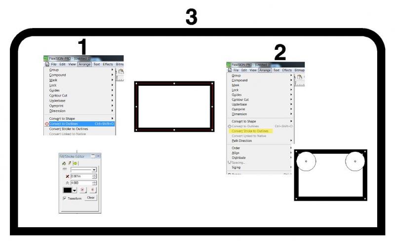

Richard G
maybe this will work better for you I know I am a picture person not to good at words. 1. is a stroke at .5 and then 1 time only highlight the box and press convert to outline, once you do that go to step 2 and your round corner tool and apply to the corner you wish, then step 3 your done. hope this makes sense to you.

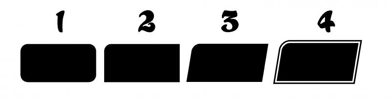

skyhigh
not sure I am understanding correctly, but I would draw all rectangles with no radius at desired size and then individually round the corners that need rounding in the box editor in the DesignCentral window tab
I'd do it the opposite way......
1. I'd draw my rectangle with the desired radius for the one corner.
2. convert to outline, then use the "square corner" tool on the 3 corners.
3. add the skew you need.
4. add the desired outline thickness and offset.
