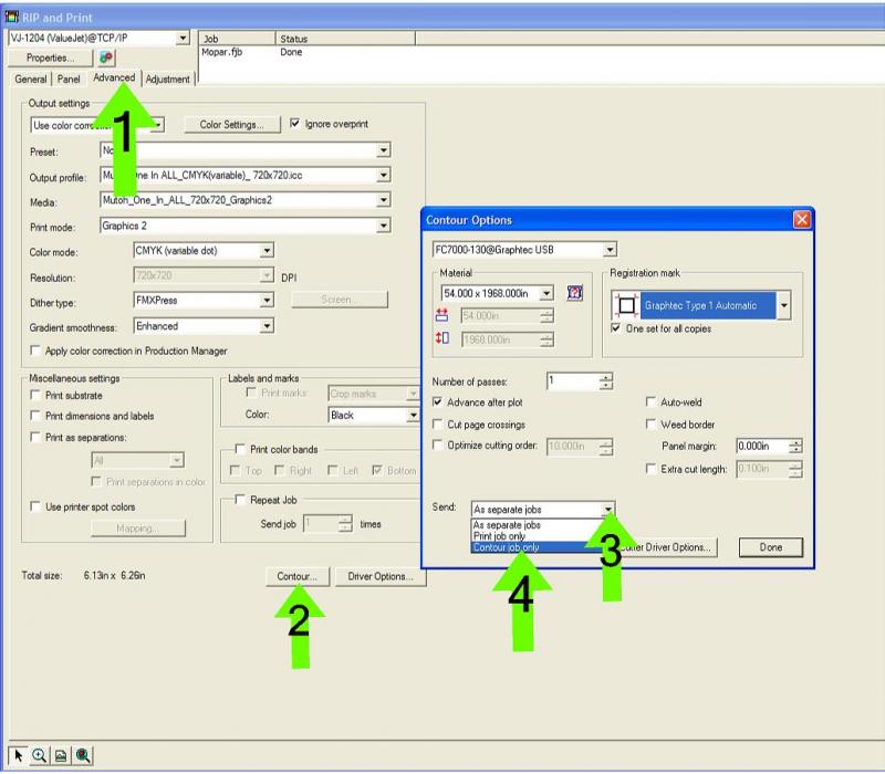

In flexi 8.5 heres how its done.

And I tried PMG's method through Rip & Print but that's not the way I sent it the first time so now the cuts aren't matching up to the print -
Originally I went into Production Manager, Add Job and brought it in like that... any other thoughts??

resend the job from flexi. when the screen says generating file switch over to production manager. Select the print job while it says riping and click on the stop button. It will stop the print from pfinting but will give you access to the cut file. Now if you altered the file in any way from when you first sent the original print (i.e. moved the graphic from one spot to another on the screen) You will not be able to recreate a cut file for your original prints.

Illusion - doing it that way has the same result as going through PMG's steps - I think this one's destine for the trash & reprint - ah well - again thanks to all for the quick responses!! :U Rock:

When this happens to me I just send it to the printer again but before you do change the box on the left side to "hold in list". This will send it to the production manager but not to the printer. Now you should have your contour cut job back and just delete the extra job in the printer que. It will be listed as holding.
