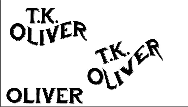

As you see I have attached a screen shot of my problem.
I used "flag" to get the look but now when I rotate it the font distorts completely.
This is far from the first time I have had this issue when it comes to using any of the warping tools. Can someone please give me some advice on what I need to do? I would very much appreciate it.

That's an Illustrator effect. What you need to do after you run the warp filter is go to Object->Expand Appearance. That'll make it permanent.
Angela
THANK YOU, THANK YOU, THANK YOU!!!! I surely wish I would have asked sooner.
SightLine
After you add the flag effect, expand it.
Oops... too late. Had this sitting open and got distracted.... lol
James Burke
ALWAYS make a copy of your original text before expanding. Believe me, you'll kick yourself if you don't.
