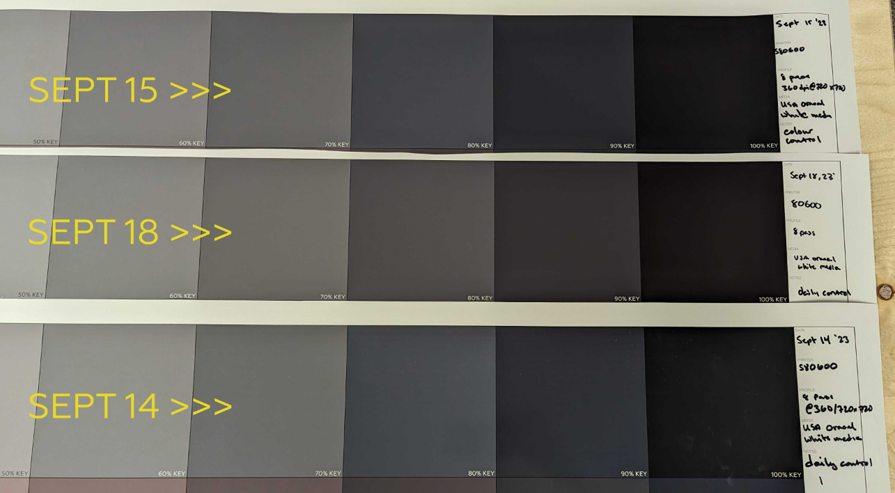

some screenshots of the shifts in color.
In theis image, colours were consistance before sept 15. Come back after the weekend, and the color is now consistant with the Sept 18 prints. Screen Shot 2023-09-20 at 4.18.06 PM.png
This next image was taken back in March. These files were never re-RIP'd. We just release it as it is in our RIP.

Yikes, that's a huge shift.

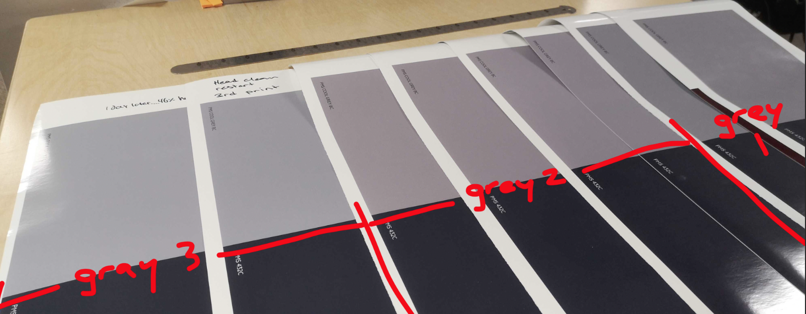

I actually just had something similar happen on our S60600 (2 months old) with a grey as well.
Printed hundreds of swatches to match something existing on a customer's site, got a sample approved and 1 week later that same swatch (not re-ripped or re-loaded or edited whatsoever) printed noticeably different.
We ended up having the re-match our approved swatch, compared swatches with our i1 and quickly ran the whole job while we were still hitting that same color.
There was a temperature difference in our shop of about 2 degrees celcius and maybe 5% humidity - only changes between initial sample and reprint that didn't match.
Does anyone know if these Epson printers are extremely critical when it comes to environment/climate control?

You dont have to remake the full ICC, just the linearization is ok if it wasnt a head crash meanwhile. If u had a head crash, u should make a full bidir adjustment and if its not perfect, all the ICC again

so what rip are you using? to confirm, you are or are not linearizing your prints? exact same roll of material? I know Onyx pushed out a print driver update for my two s40s. Im assuming they pushed new drivers out for all. Where they updated? Where/how are you storing your sample roll that is being used for these tests?

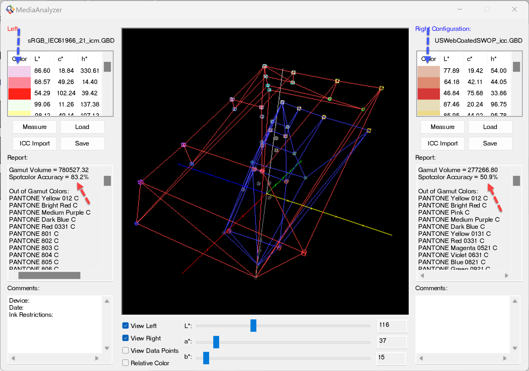

When people set up files, they are working in an established color space. If using Illustrator, those color spaces are designated as either in RGB or CMYK. The default CMYK Color Space is USWebCoatedSWOP. This can be changed in the rip to use the predetermined color space set in the rip ie Gracol2013 or use the embedded profile of USWeb attached to the file and what the designer determined as the best color space to use. In my training sessions, I always ask, what color space do you work in when designing files. Most do not know the answer. This tells me they are using the default of USWebcoatedSWOP. If the quickset used to open the file in ONYX is set to use Recommended G7 Profiles, the USWebCoatedSWOP will be converted to GRACoL2013. It will also convert the default of RGB colorspace of sRGB to Adobe1998. CMYK rendering intents will be converted using Relative Colormetric with BPC and Perceptual for RGB. So a file set up in a specific colorspace determined by the designer should be used to preserve color integrity when processing through a RIP, hence the setting to use embedded profile when available. If that is unchecked, it will always be converted to the colorspace set in the rip.
ONYXtechtips
To get a better visualization of the difference between RGB and CMYK, I have created this chart to show gamut volume for each. If you set up your files in RGB using the default settings, the color space is represented as the red wireframe and has a tremendous color gamut in comparison to the blue wireframe which is USWebCoated. When designing in RGB your palette is big and looks great on your monitor - full, vibrant as shown in the color watches in the top left. Conversely, the same colors are determined in the right side under the USWeb. They are in no way the same color. The color space of your printing device is going to be much closer to USWebCoated because it is a CMYK colorspace and these are the colors you are using to replicate color. So if the settings in the RIP are different in the three areas files are being brought into the rip, the desired color may not hit what you expect.
