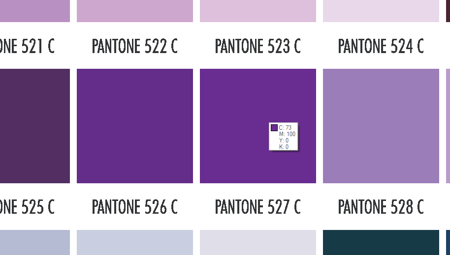

I attached my color chart, import it into your design software save it where it's easy to access & then export it as you would normally export a print file.
Print it, mount it to scrap substrate. You will need to go into the file to see what the values are for that color, because it will be different from the same PMS color
in your design program's PMS color pallet.

trouble with that pdf chart is that the actual color swatches are cmyk not the pantone. Doesn't say what version either. I tried matching using various pantone versions and get a much different outcome.
Andy D
That's why you have to go back into the file to see what the values are, regardless if it's CMYK or RGB chart (I use CMYK because that's what I have always used for color correcting).
If I match a color to 523c on my printed chart & then find out that color is (as shown above) C73 M100 Y0 K0
& I use those values on the same material, I will get that color (as long as I'm consistent with how I export my print files)
If you have huge color shift between material, you will need to create a couple charts.
