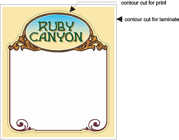

kind of off topic but i see a decal that has laminate bigger then the decal, or atleast its clear around it, how do they do that cut it out then laminate it and cut again?
Mosh
Send the art print and cut white, using aglinment marks. Weed and laminate. Then put it back in the printer and import the same file, only with a contor cut for the clear only. cut only.

This will work to accomplish what he's seen. But my question is why would you want that?

Here's why you'd want to do that. Here's a sketch of a recent job. These were prints laminated with dry-erase mounted on foam core. The print wanted to be cut to the actual contour of the image but the dry erase laminate wanted to be cut so that it completely covered the foam core substrate. I guess I could have mounted the prints on the foam core and then laminated the result but the pre-cut foam core blanks were provided and I chose to print, contour cut, weed, laminate, and then contour cut the laminate. Both contour cuts used the same set of registration marks.
