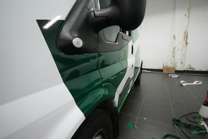

well here is a photo
different kind of bubbles. The large ones like the one in the line i pinch. But can you seel all the other tiny ones? those will go away?

give it a few days out in the sun.

well. he have sunny days at the moment but the vans are usually in a warehouse, and only get out for deliveries

well, after one week i saw one of the vans i made and it was much better, but still some bubbles and some "vinyl stretching" marks.
