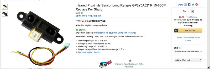

I was just thinking about this yesterday, actually. Does it look anything like this?
tulsagraphics
My prototype uses an ultrasonic rangefinder. I looked into many types of sensors when building the prototype (including the one you mentioned), and the ultrasonic rangefinder was the only one that had the capacity for reliable distance measuring (necessary for my programming method).
Here's the thing: Most sensors detect objects at a maximum range at all times, which means a lot of false triggers without additional programming (hint: the infrared ones have a very short detection range).
For example, the ultrasonic range finder that I'm using can detect distance up to about 30 feet away (although not very useful if it's beeping at every object in the room, such as the opposing wall or work table), so what I'm doing is programming (in the firmware) a way to detect and report the distance of whatever the sensor is finding -- but it only emits a beep (at the specified intervals and frequency I programmed into the firmware) -- and for my prototype, I programmed it with a maximum detection range of about 22".
