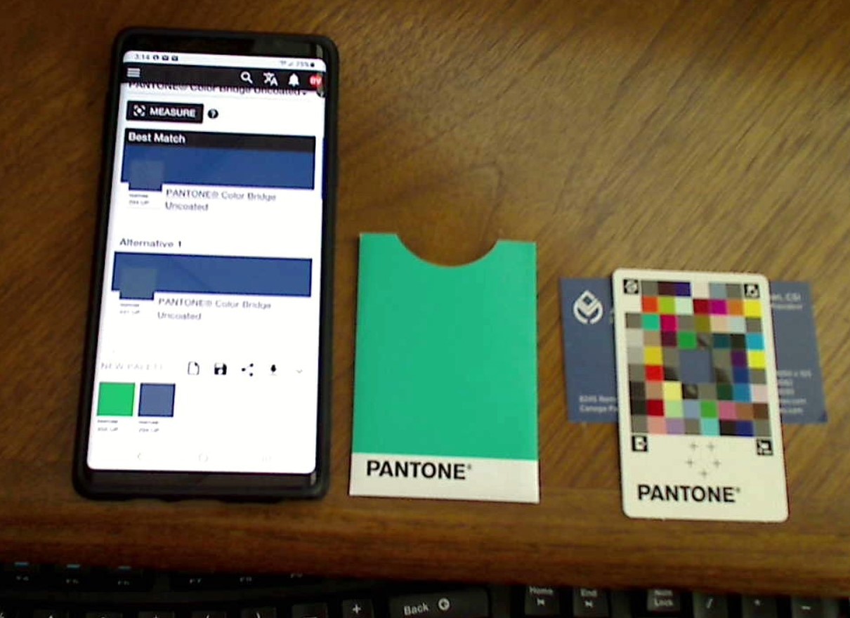

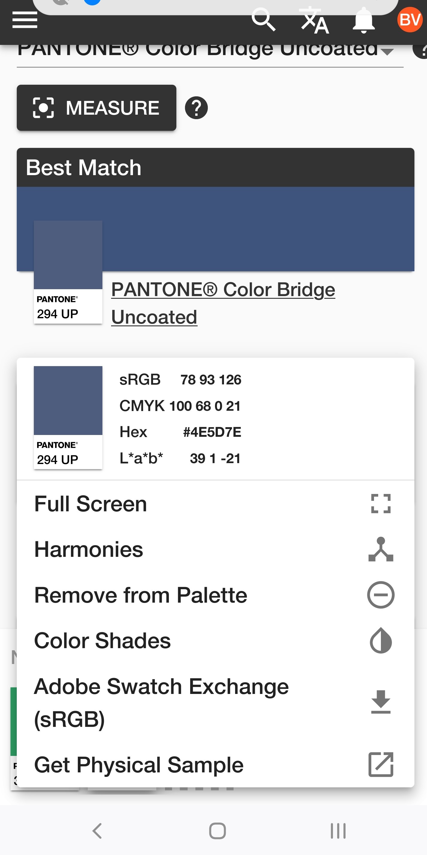

Another option is to purchase a Pantone Color Match Card for $14 and try out the new Pantone Connect app (same as x-rite Color-Eye) and see how its results compare with your i1. Given the quality of today's smartphone cameras it should be pretty accurate when using a fresh card. I just received my card and have played around with it some. In the first photo I've measured the card's envelope and a brand color from a business card. In the second photo I've tapped on the blue swatch and the app is showing me the color's properties.
