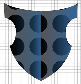

This is what I'm trying to accomplish in Flexi... know how to do it in Corel Draw very easily, but not in Flexi, which is where I really need to..
Thanks!!!

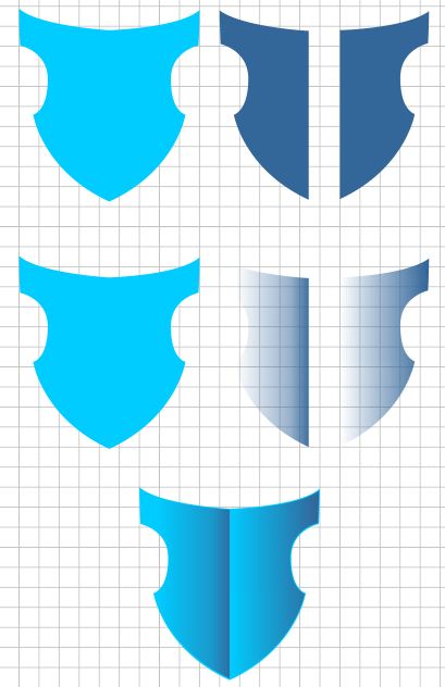

I thought that might come up after I posted. Perhaps this will better illustrate what I'm looking to do...
Thanks so much!

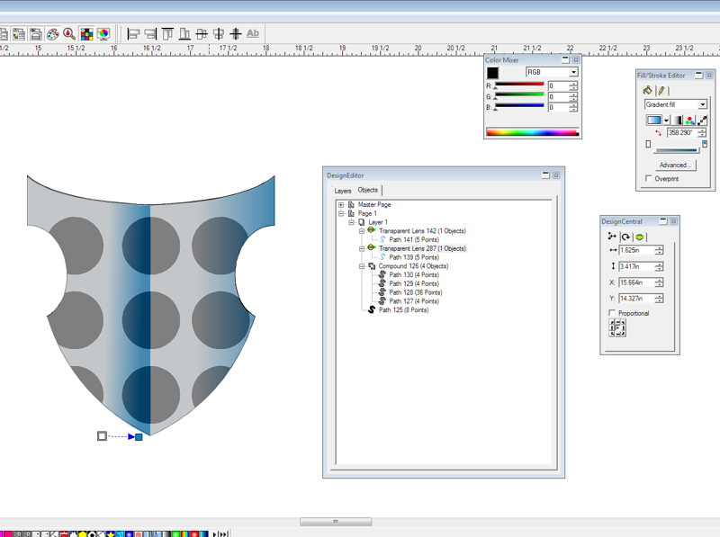

I think this might work.
I took the base object duplicated it 3 times
so now I have:
base solid object black
second object with holes gray
3rd object - left half of the shape - gradient blue to white
4th object right half of shape gradient blue to white.
transparency lens on #3 and 4.
3 and 4 could be one object with the gradient adjusted to get the effect.
this is in Flexi 8.6 maybe v10 works better.
All I can say is that I am glad I am not limited to the tools in Flexi to do drawings that are more than simple geometric shapes with solid fills.
