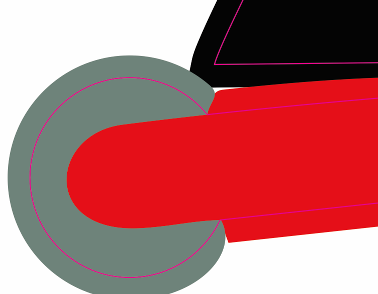

Create a contour of each color, separate then send to back. Still need to go in and mod the nodes in different areas
