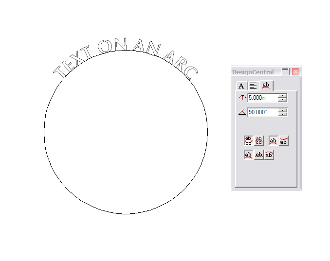

There are two different ways to create arched text.
1. Text on an arc. Select the Text on Arc tool and type away. Control is by size of circle, size of text, justification, spacing and kerning. The tool is located under the main text tool.

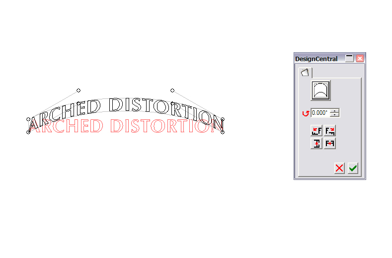

2. Arched text by distortion. Type the text with the standard text tool. Select it and click on Effects > Distort. Select the desired distortion and adjust to suit your needs. There is more than one distortion that will achieve the effect.
