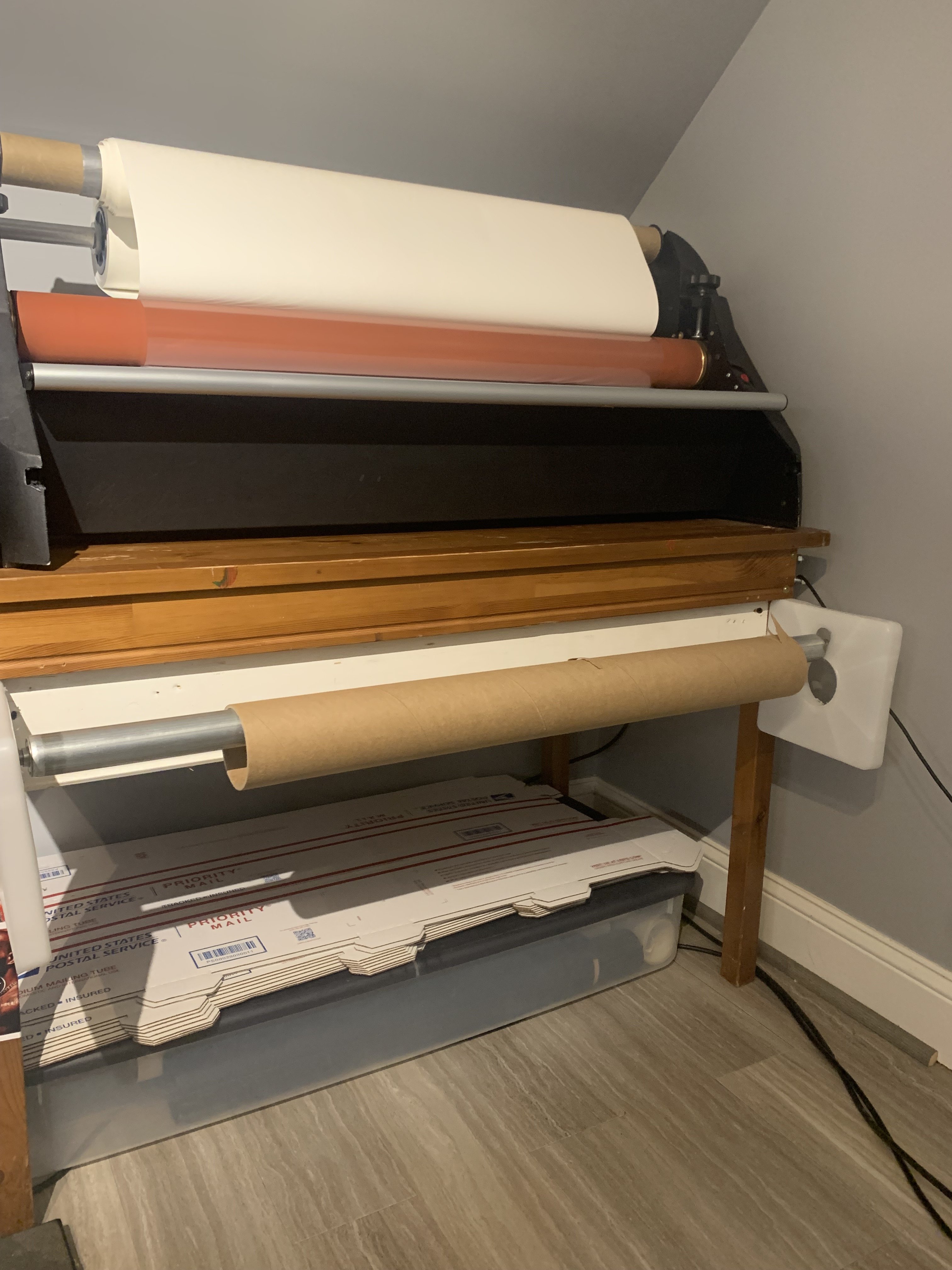

dsignerchic
Here is my homemade set up. Works WAY better than you think it would. Pole slides up and out to load prints, it hasn't failed me once since I set it up.
