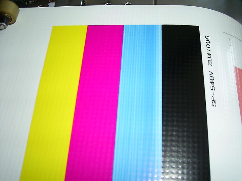

Did the "Fill" print test from the Service menu. Blk, Magenta, and yellow all solid. The Cyan was full of banding, and the Black has "Overspray" around it.

I would definitely change the dampers. When we had our head replacement scare on out 540V it just turned out to be 2 dampers gone. Did the service myself in a short afternoon after we got the parts in, not much to it.

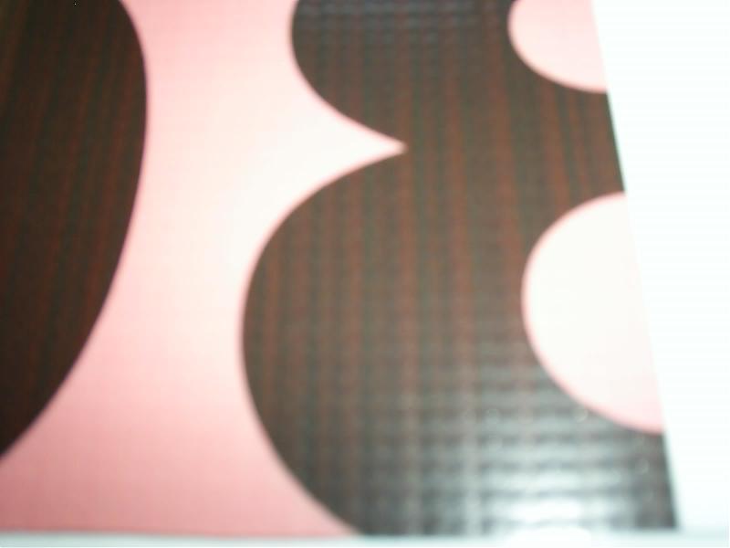

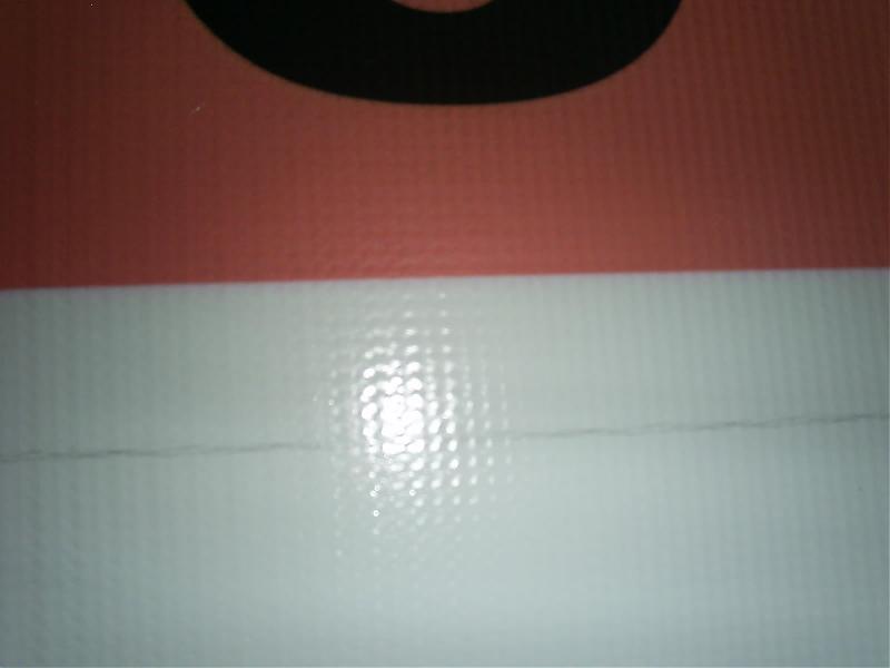

Here is a couple of pics of the problems. Test print and what the "Crop Mark" looks like next to the print. Crop mark looks like a spider web.

Ok...changed the Dampers on the blk & blue ( only had 2 ), and the blue damper was all ballooned out. Banding is gone, but still have fuzzy crop marks. I have been having encoder problems, and have cleaned it 3-4 times, so I think I will get a new encoder, and give it a try.
