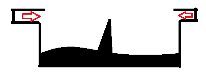

You just poke the bottom with screwdriver or something to make sure there is no ink tower built up.
Then some compressed air to the sensors on both sides on top.
