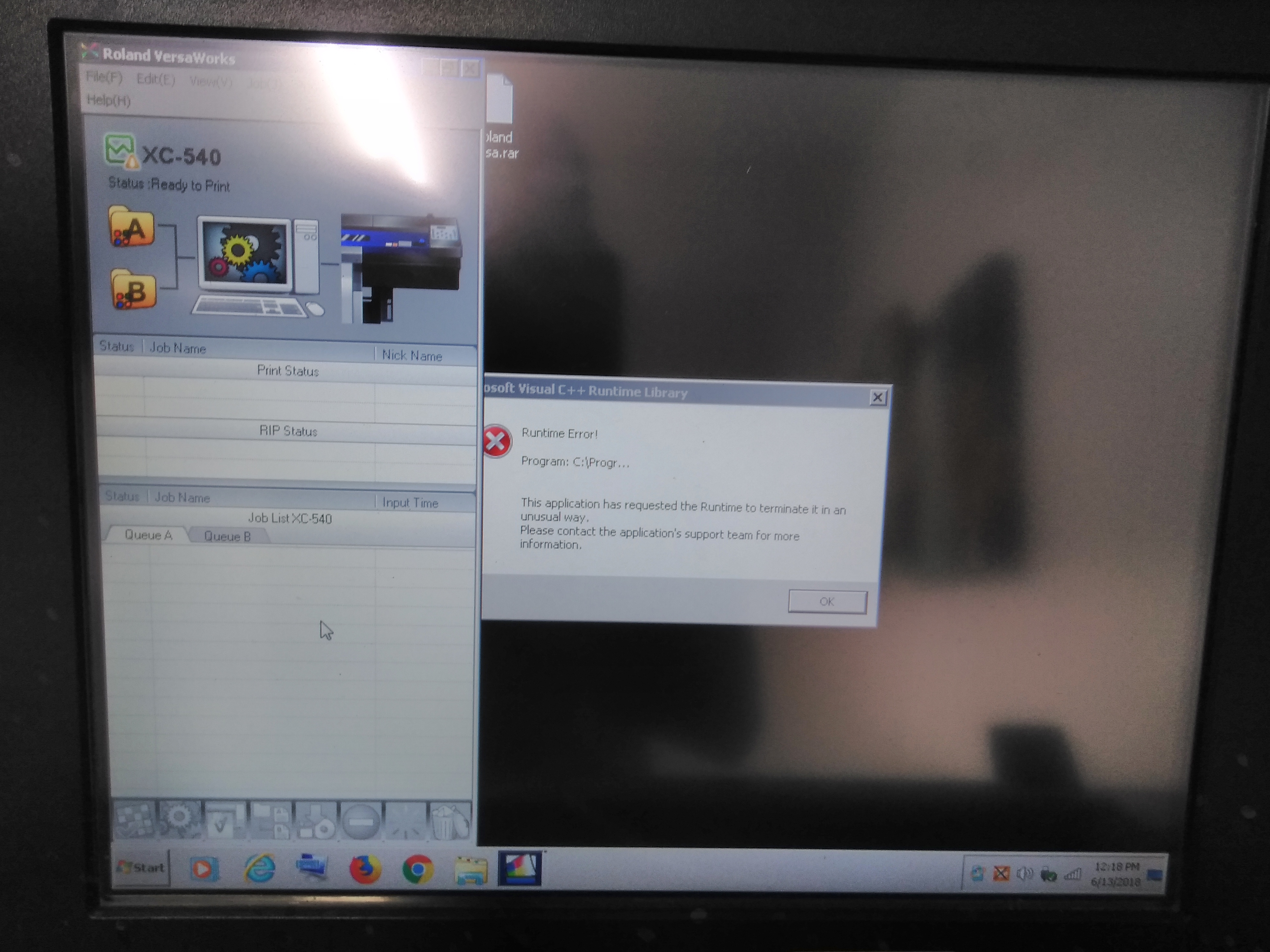

I got the print connected and received this error the versaworks stop
my computer running windows 7 premium
