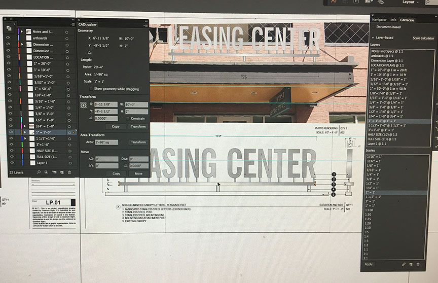

It's actually far easier to work in scale where you have multiple scales at your disposal... no scaling up or down... just start drawing where the sign will fit the page for client/architect/municipality and all the tools to do the call outs...

I'm still thinkin about CadTools and that $349 Rick....(Hot Door - CADtools - Overview) so for time being still using Corel Draw x7 with architectural scaling...
Hopefully if work slows down I will do their trial for adobe and justify the expense...
