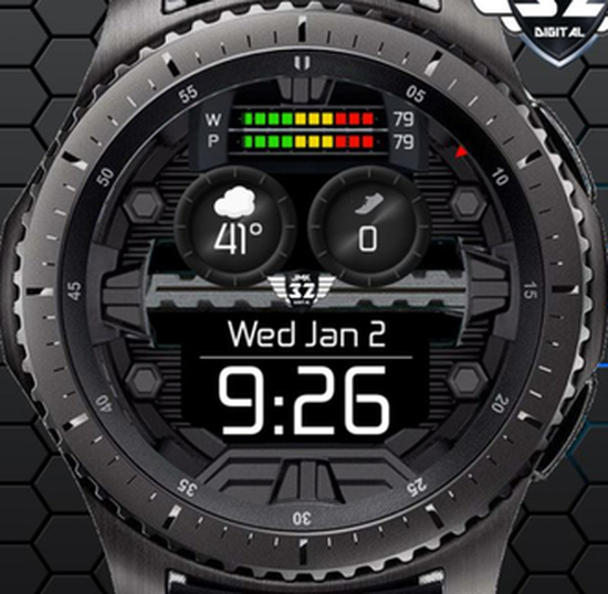

Thanks to all of you for your help. I admit that I am very rusty in working with Flexi as well as Photoshop. I did create a shape in Flexi and export is as an .eps file and that worked great. I was for some reason thinking that I had to export the file as a .png file. Photoshop handled the .eps file from Flexi just fine. I need to do some tweaking and experimenting with the resolution to get it just right. I guess that I should explain what I am using these graphics for. I use and wear a smart watch to which I can create custom faces in an Android app called "WatchMaker". I want to create custom shapes to use in building these faces. I would appreciate it if someone could tell me how to cut these shapes out of image backgrounds such as a carbon fiber image. I know that I could probably add that image into Photoshop as a pattern file but I have many textures I want to use eventually. I tried importing a carbon fiber image into Flexi thinking that I could cut the shape out somehow but I can't get that to work either. I have added the attached image of a watch face style that I want to use in my quest for learning all of this. Again, I thank all of you for your help.
