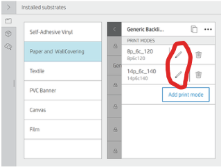

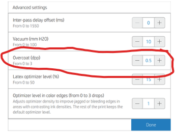

1) In the Media Preset Print Mode at the front panel of the printer (under Advanced Settings - this is a global setting that affects all jobs using this print mode) set Overcoat to 0

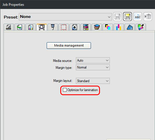

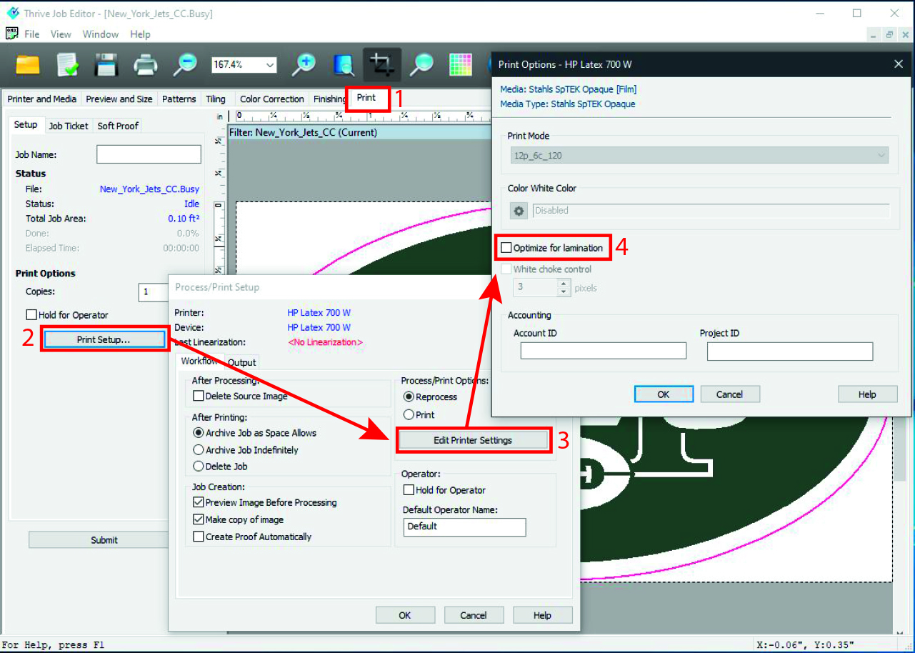

2) In the RIP (enable the checkbox called Optimize for lamination (this control affects this specific job only) - see attached screen grab in SAI, and Onyx has the same functionality

1. The problem is I can't see the Advanced Settings - where should they be? I've looked everywhere.
2. I have Onyx. I checked everything there - I can't find the "Optimize for lamination" checkbox or something like that 1630122343660.png

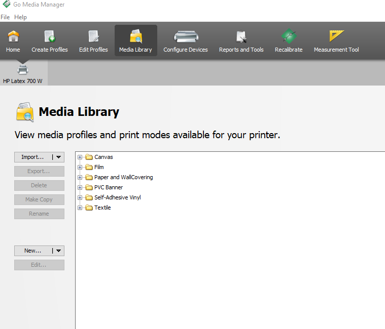

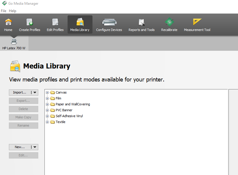

I recommend to make a duplicate of the profile you use most and name it "Your substrate - Lamination". Then go through every print mode and set Overcoat to "0". Just the easiest way in my opinion and you never forget to turn it off when you select to use that.
Go edit the material you use, hit the pen, scroll down to advanced settings, set overcoat to 0. Then go back one step and continue, continue, finish to save it.
To change it for only one job in Onyx:
Right click your job in the queye -> Edit -> Printer settings -> "Optimizer for lamination".

See attached for the location of the Optimize for Lamination checkbox in Onyx - it is located in Job Editor, and not Media Manager.
