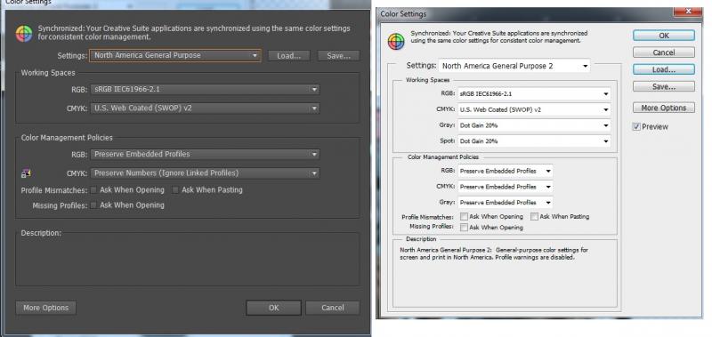

In Illustrator- Go to Edit -> Colour Settings. Check your working space profile.
In Photoshop - Go to Edit -> Colour Settings. Check if it is the same. If not. Change it.
Be careful when you save it though that you save it with the same profile. Write down the profile type you are using on a piece of paper for future reference and archive it!
When saving to pdf. Go to EDIT -> PDF Presets on either Photoshop or Illustrator and create a pdf preset with the same profile. Then use the same preset on both.
I hope this has helped. I am using ISO Coated v2 (ECI) all across our international platform and we havent had a problem yet.

I followed check with you
but It look same as first.
left is AI , right is PSD
but when I print .AI is same color as source , but .PSD it very brightness than source
peavey123
ok, well you're not printing .ai files so check your settings when you save your print file. My guess is the colourspace is being changed when you save your PDF, EPS etc.

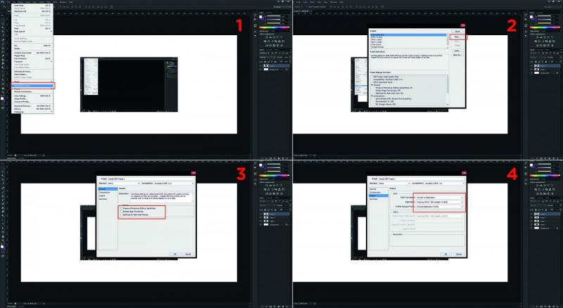

Kaiser
Create a PDF Preset and use that on both. That way your output is the same on both. This is what I use.
Edit. Adobe PDF Presets. NEW.
GENERAL
Uncheck all
OUTPUT
Colour conversion - select convert to destination . Destination - Set what output profile.
Then create an action to batch process files using this preset.
Select a Name that you'll not get confused with. That way you can use the same preset on Illustrator and Photoshop without getting confused.
