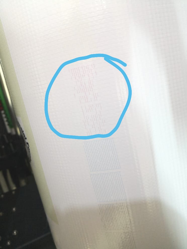

I have this dx5 on a MT refretonic 1.8m printer and didn’t print for three days due to some issues and now after long pumping and strong cleaning it wont just print the magenta right meaning it has a lot of lines missing as shown in the photo compared to other color, i.e all other color print fine without and gaps on the nozzle test.
What is the best way to fix this magenta issue
Please help it makes my printout so bad.

You can try soaking a lint-free cloth in cleaner and placing ONLY where the head sits on the capping station for a few hours or overnight[as the solution melts any plastic it come in contact with for long extended periods].
