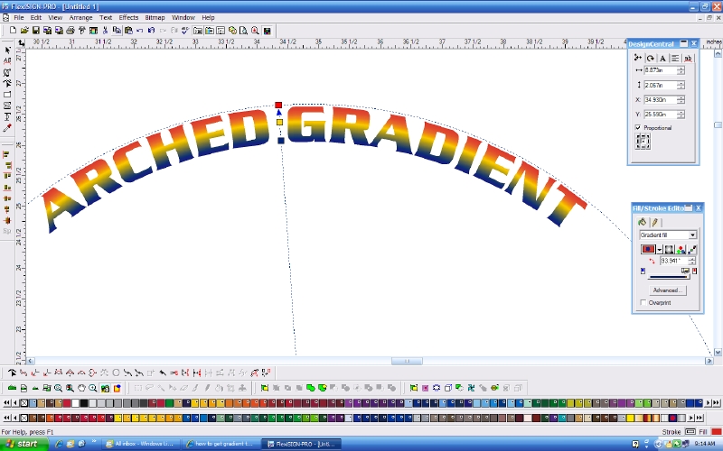

Graphics2u
Apply the arch first and then fill with radial gradient and adjust it to fit the proper arc. You should be able to resize the text by using the bounding box and keep the gradient from changing but if you change the arc of the text or the size of the font or the properties of the distortion you will need to adjust the gradient.

Flubber
That works so much better than the way I did it.....Ty....I love learning easier ways to do things...:U Rock:
Mr. T
I used it and it worked! I just have to try to smooth out the gradient. It had some wierd bands in the fade.
