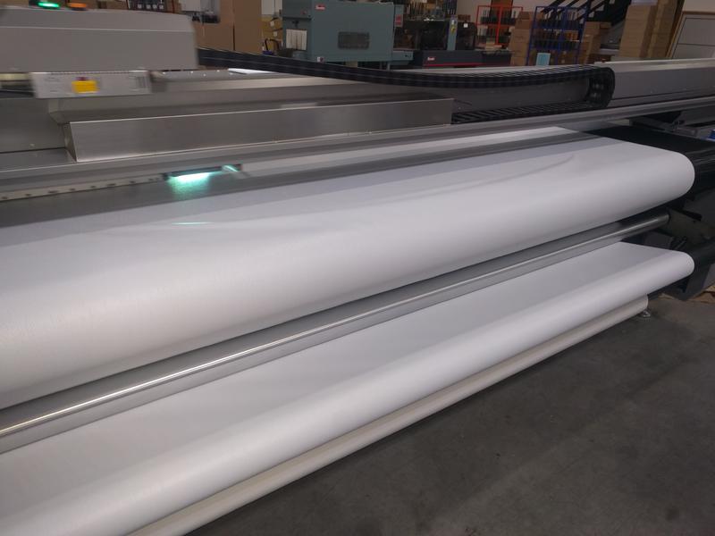

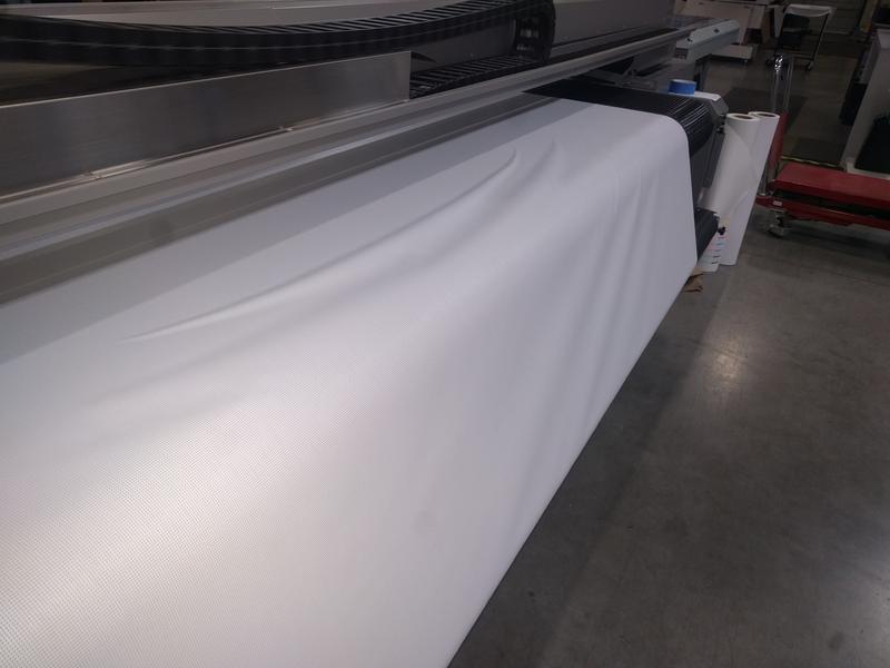

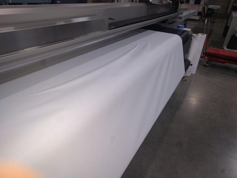

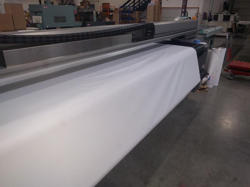

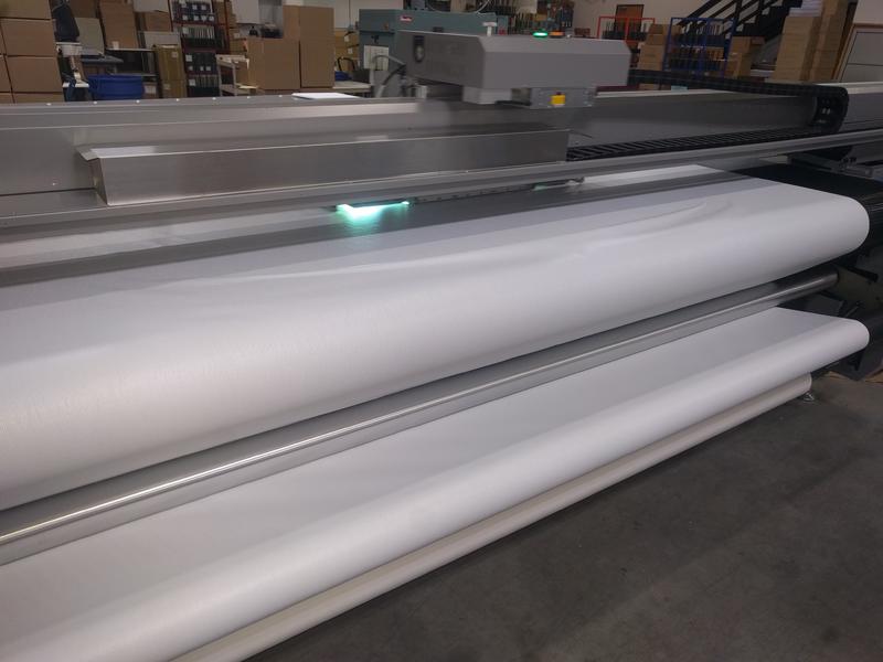

We have a 126" CET Hybrid printer. We have found a need for printing media larger than 98" quite often, but we see a common problem when printing on larger media, the material seems to buckle in the middle which creates headstrikes! The CET does come with a dancer bar on the back, and it the attached photos you will see I've tried the dancer bar two different ways, but it doesn't seem to make a difference/correct the issue. This issues occurs the most on Mesh Banner - Strip Mesh Pro from Ultraflex. Does anyone have a solution to this issue?
Attached are photos of what I mean when I say "buckling".

Don't have a solution but we have the same problem with our H1625LED. We were actually talking about this, this morning. My theory is the surface under the belt isn't truly flat or the roller isn't truly flat causing the media to become narrow over a number of feet. We often have to baby it to finish long banners. Quite frustrating....

Thanks for the response. I am not surprised your VuTek has the same issues - the frames for the CET and the Vuteks (our at least that is what I have been told) are made in the same factory before being shipped to CET/VuTek to be customized by the manufacturers - so they use the same media and belt system for the hybrids. I could be wrong, but isn't the H1625LED a 64" wide printer? We run a lot of 63" mesh and don't see this issue, it doesn't really come into play until we get to 98" or wider - which I was told was because when Ultraflex (or more appropriately - the Chinese factories that actually make the banner materials) manufactures the materials that the middle of the wider rolls tend to sag which creates more tension on the edges and that is why we see this buckling when printing because the material is slightly longer in the middle of the rolls compared to the edges... but I just feel like there has to be a solution I don't know of yet! If I find a solution I'll be sure to post it!

DSIG, it certainly makes sense. Yes it is 64" We have see this in 54" rolls. It has four separate vacuum areas. We haven't played with those much but I was thinking of putting the two center ones on high and the outer ones on ultra low. It makes us nervous running long banners because we know that it's likely to occur. It does seem to happen more in 13oz vinyl than paper stock. We will probably have someone come out and take a look at it because we are still under contract. If they fix it I will be sure to post something.

The material ripples because the belt moves. If under warranty, place a service call.
