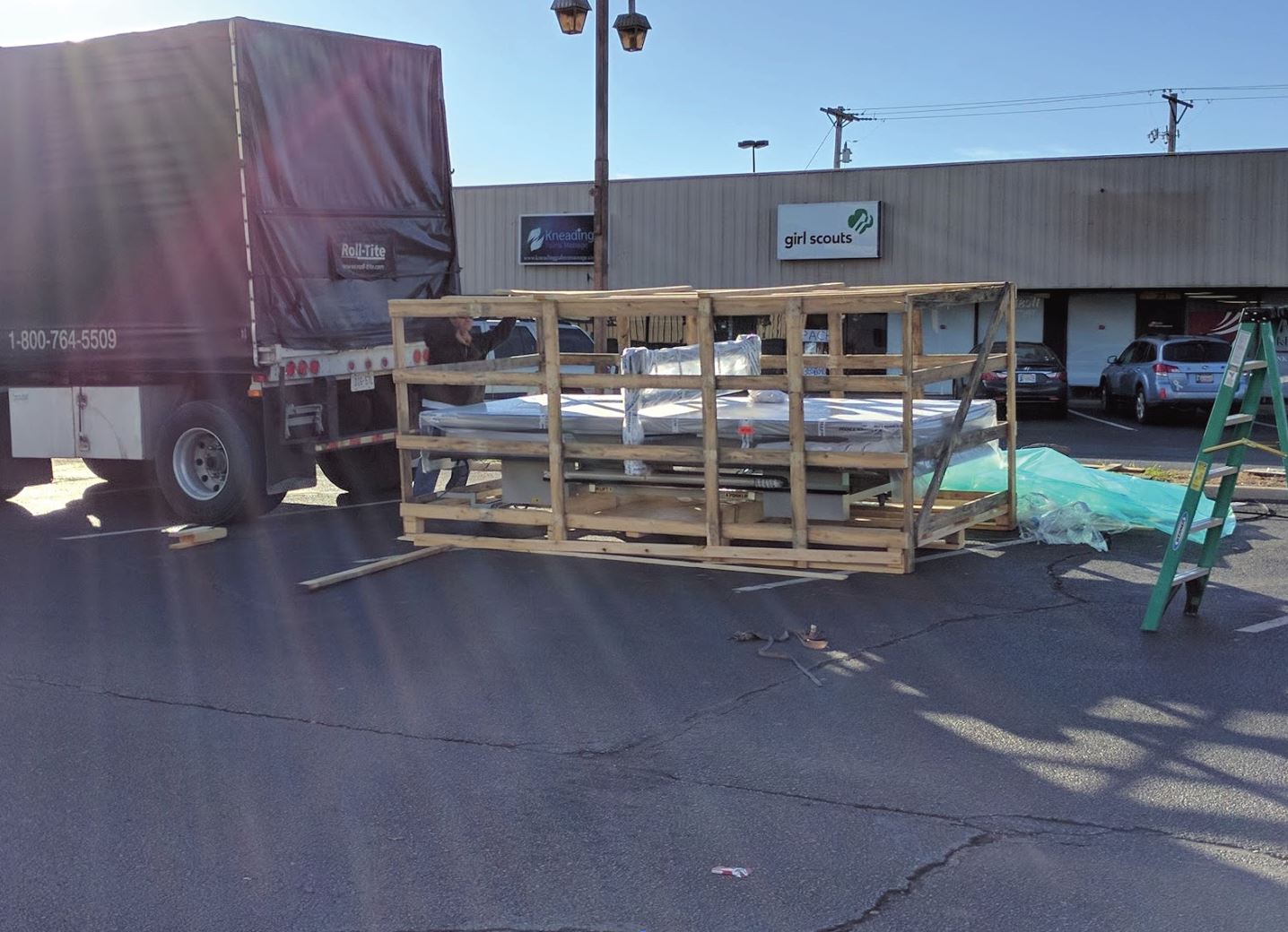

Out of 3 rental companies, only one place had a forklift, and it had the short forks. This wasn't going to work at the short end of a 1,700 RollsRoller crate. So I had a local fabricator weld up a steel A-frame with scrap material (not pictured), same height as the truck bed. Used the forklift and straps to pull the machine out and placed the A frame under one end. Drove around and grabbed the machine from the long side, secured it to the mast, had the driver move the trailer forward, moved the A-frame out of the way and lowered the machine to the ground. Worked really well. ($150 for the steel A-frame was nothing compared to the cost of dropping the machine).
