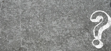

The client asked to make a removable wallpaper. I printed on regular "removable" vinyl.
But it turned out that half of the walls where I need to apply vinyl is concrete. Sufficiently smooth, but nonetheless. I am afraid that regular vinyl will not adhere well to such a surface.
Perhaps something can be done? Instead of water during installation, I can use another liquid, perhaps?
Thank you very much in advance!

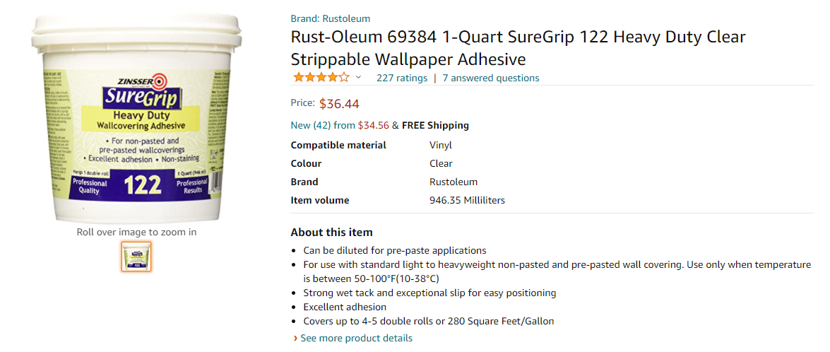

Here - there are special adhesives for vinyl wallpaper - this is the same vinyl film. Moreover, it is used both for those with a glue-coated vinyl wallpaper, and for those without. Heavy duty! The glue is water-based (that is, can you say "temporary" about it?)
Should I try or not suffer? :)

You are asking for trouble trying to add something to make the vinyl more aggressive. This just needs to get reprinted on the proper material. Site evaluations are always important to know exactly what you are working with.

I wouldn't mix the two, I think the adhesives would be different and you would be gambling. There are digital vinyls specifically for concrete applications, think ball park or stadium graphics.
