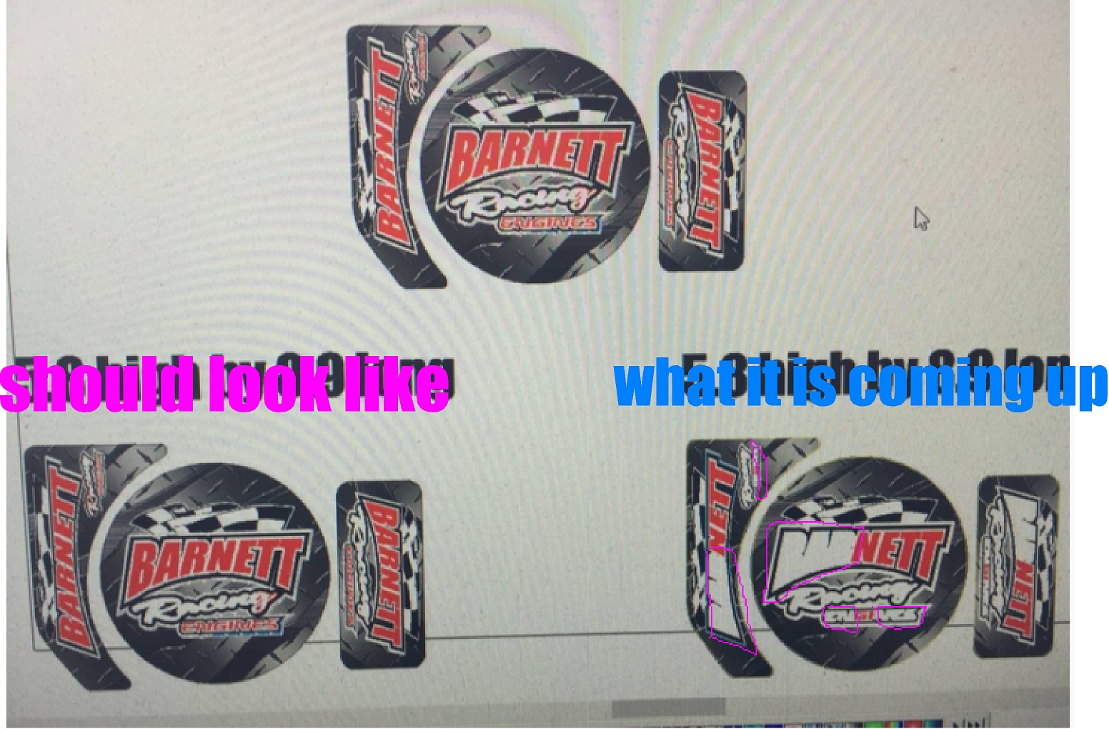

149motorsports
The lower right hand one has the red missing in the lettering and it turned to white. I attached the picture of what he sent me.

Looking at the image it seems the "BAR" text/paths are either open or are wound the wrong direction on export.
Need to either close the path or use the "Path Direction" tool to flip the direction and try exporting again.
Not sure if Flexi will fill open paths the way Illustrator can, maybe no need to try and close the paths.
I would not be confident sending Flexi generated vector files to someone else to open and print (Flexi & FUBAR both begin with the letter F).
I'd flatten everything to a single layer bitmap at production size (except the contour cut lines, if you have them) and send it as a pdf.

Now we have new info.
If your printer has Flexi that is the best format to keep it in. No need to introduce PDF issues into the work flow. Just confirm that his version is at least 10 or higher (same or higher level than you or you will have to save down and that can add more fun to the job).
You shouldn't have to rasterize sending flexi to flexi but if that has already failed:
Select everything in the file go to the "Bitmap" pull down > rasterize > check the transparent box > resolution to 150/ 200 (depending on how large the print is and how small the details are) > OK
With the bitmap selected >Effects > contour cut > set the options you want > Ok
Save the file to the version of Flexi your printer can read.
That should do it.
If the same part of letters turn white when you rasterize the whole file then you'll need to go back to vectors and select the paths and use the "path direction" options under the "arrange" tab to sort it out.
If they won't stay red - post a small section of the file here that has the issue for someone here to take a look at.

You could export to PDF and then open it in Adobe Reader to confirm that everything looks correct, before sending it to your print vendor. That's a pretty safe way to avoid errors. Ditching Flexi and using Illustrator is safer, though.
