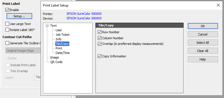

Hello using Onyx to print my wall murals in the job editor is there a setting to also print which panel is which. like Insetting a number at the bottom of the print so that i don't have to manually trying to figure out in which order it goes.

You need to enable "Print Label" in the Finishing -> Marks tab and adjust as needed:
