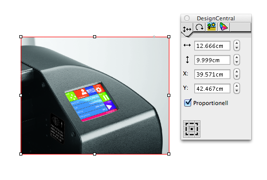

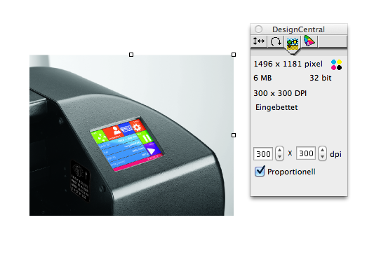

In the Design Central, when clicking on an image on the workspace, you can see the size of the picture in the "Size"-Tab and the resolution and dpi in the "Bitmaps"-Tab (see enclosed pictures).
