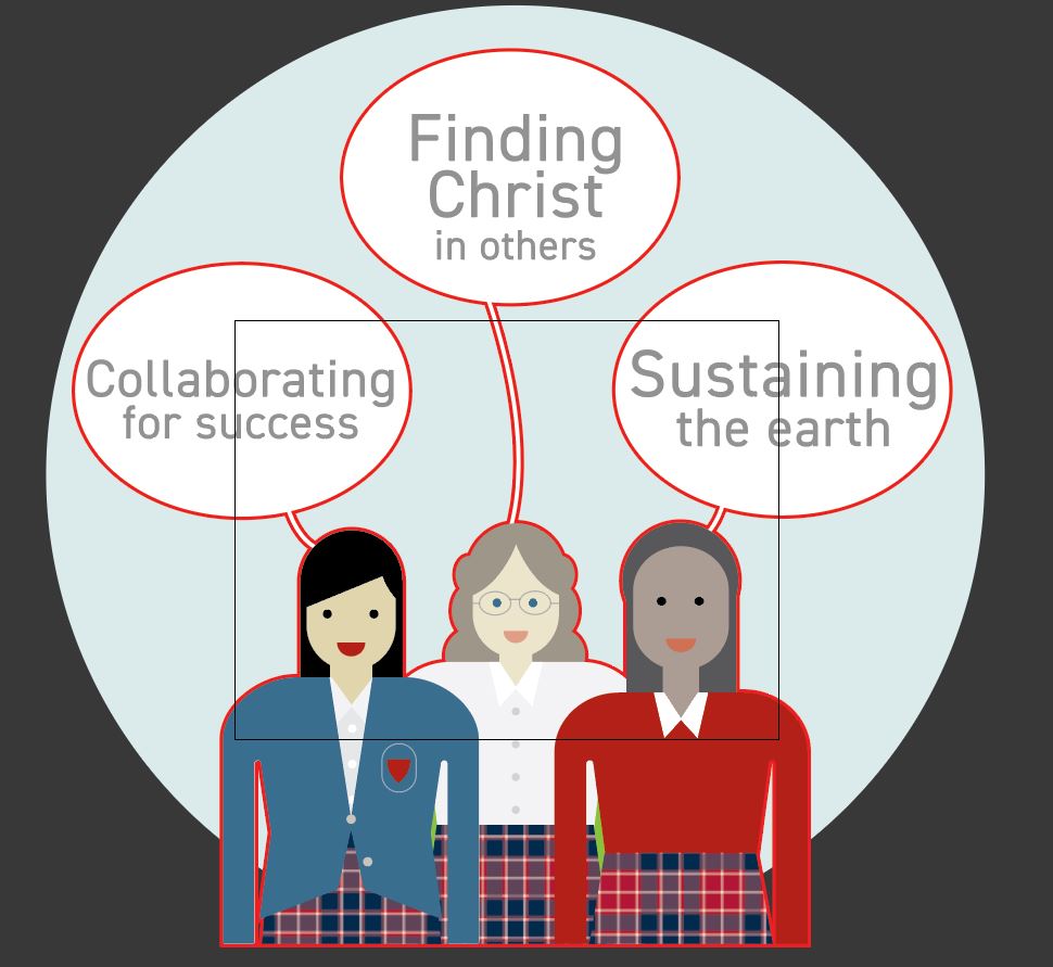

I use a Scitex FB750 with Onyx rip software. I'm trying to figure out how to underflood only a portion of an image. I've attached a screenshot of the file I'm trying to accomplish this with. The portion outlined in red has a solid spot color behind it. I need that to underflood, but I need the bluish background to print without white so it is translucent. Does anybody know how/if this can be accomplished?

White is just like any other ink. You can do all the same things, text, black and white Images, gradients what ever you can imagine.
iprint
Bring your white to the front, on top of the image. Also, make sure you have Overprint fill selected in the attributes panel in Illustrator.

Are you doing this solely in Onyx, or does the artwork have the spot color where you want to print the white ink?

I wrote a very basic tutorial covering it.
it basically follows the onyx guide but a lot more simple and to the point.

To the OP, Pauly's guide is probably the most concise in comparison to the Onyx guide, the only think to be sure of is that your Spot Color mapping is correct in Onyx. IIRC from our HP 750 there are a couple tweaks in Onyx that make a big difference.
