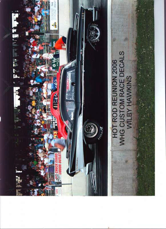

how can i cut just the black car out of this picture using flexi pro 7? any help would be much appreciated! i am making a wall sticker for a birthday Picture.jpg
zmatalucci
draw around it with then pen tool... then with the shape of the car that you created on top...mask it....then contour cut
Brandon708
just use the Bezier Path Tool then mask it and contour cut.
I would suggest you bring that picture in photoshop and correct the levels or just use the Auto Correction to get it to look better.
edit: I fixed the picture for you.

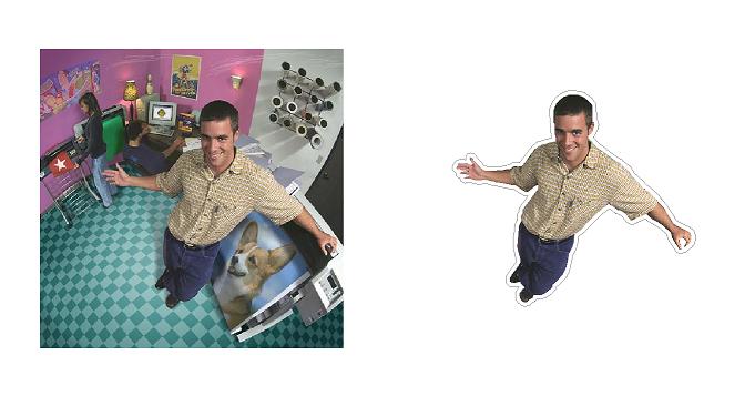

This process may seem long and painful, but it is the only way... and with great results in the end (see screenshot)
image to the right has a contour cut on it.
