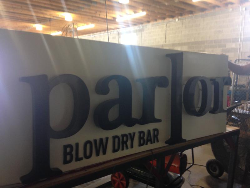

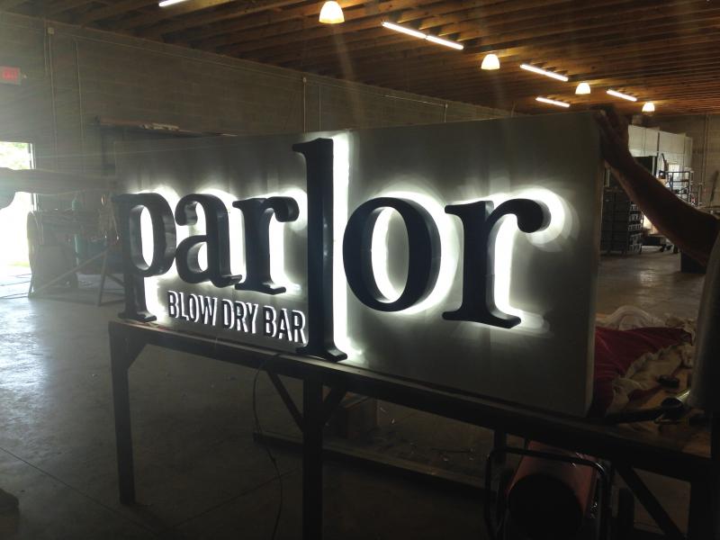

This appears to be Self Contained Epoxy Resin filled 1" Acrylic with LED illumination, mounted to flat aluminum with standoffs.  Probably a blockout vinyl overlay for the faces, hard to tell from the photograph.
Basically, the 1" acrylic letter is hogged out in its back and LED ribbons are inserted before the letter is filled with epoxy resin, sealing everything in place. You can paint the returns or leave them clear and sandblast for diffusion if you want edge lit.
