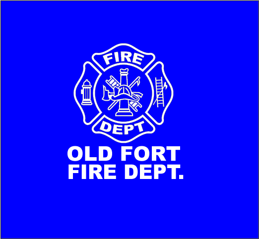

I did 18 shirts for a fire dept. and I made the text 14" wide and the customer is asking why I did it so small.
I do know that is a lot of real estate to cover, but what would you do?

Guess I am going to ask the customer to get out a yardstick and tell me how wide he wants.

Yea they were 18 3XL Gildan Ultra Cotton shirts and smaller sizes I haven't done yet. Its just simple Arial Bold text on the back that he wants wider.
Im using white Easyweed vinyl, and he has loved the shirts I have done for them earlier, I guess next time I know to do one before do them all.
The difficult part for me in re-doing these is the logo I am doing for the chest. A lot of labor in weeding.
Guess I am gonna eat the 18 shirts. Maybe if I soak the letters in Acetone or MEK wonder if they would let go? I have used MEK on small mistakes like the center of a e.

I go 11" to 12" on all shirts when I design stuff for them. seems to work well on all sizes
And to think I did his letters 14 inches wide. He has yet to bring me the screen printed shirt that he wants me to emulate.
I almost bet you the letters wrap around to some degree. I measured a guy today that had a 3XL on and 14" looked fine to me.
