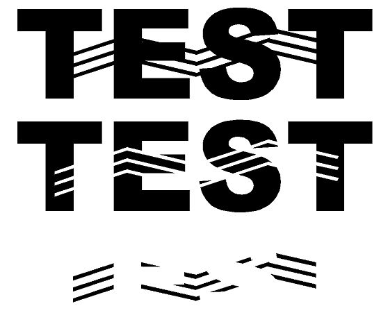

The attached is...
Top- Elements before selecting them and choosing "effects > combine > cut out".
Middle- Elements after selecting them and choosing "effects > combine > cut out". (The squigglies were on the top layer).
Bottom- Elements after selecting them and choosing "effects > combine > cut out". (The squigglies were on the bottom layer).
Change the layer of an item as described before. (Select the item, then hold control button and hit page up or page down).
Shouldnt make any difference if the text is curves or text. In Flexi8 you can even alter text after doing the "combines" somewhat.
This is in Flexi8. Hope it works for ya.
