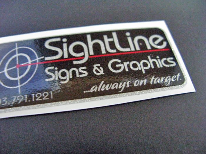

SightLine
I recently got a 24" x 10yd roll of Avery (shudder) Supercast 900 Ultra Metallic silver to experiment with for this look. They also have it in white and according to Avery's site it is available in up to 48" rolls. Since it's a cut vinyl its not guaranteed free of contaminants but so far I've found that it prints great. :) Tough to photograph it well - it is VERY metallic. White or silver should do very well for print without affecting color much. I tired a sample of the metallic laminate but just was not as happy with the effect.
