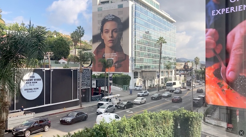

I'd say any wall banner you can get at that size will definitely hold up to the winter weather, but I can't imagine the herculean effort that it takes to assemble 400'x50' banner, let alone how to keep it taut as you install it. Paneled ACM could work, but that's a lot of holes, plus all the seams. Alumagraphic, sheeeeeet, whatever salesman handles that at the distributor level will start showing up a good deal more often!
Have you tried talking them into a projector? Or ideally, a whole Daktronics wall, but now you're talking 1-2MWh...
This is more than a tough cookie, it's a scone or like a biscotti or something.

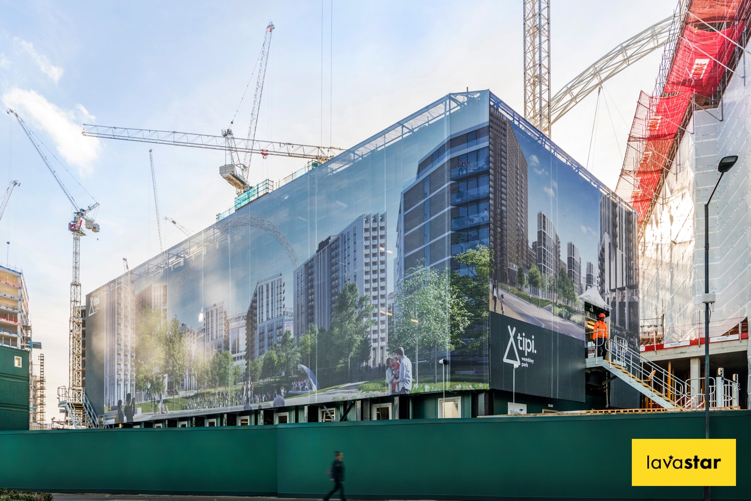

Boss is going down there this weekend to do a survey & get the budget. We've done some work on other buildings in the area this is, and they're not tightwads, but there will be a limit.
I know what Daktronics cost, I'm pretty confident that'll be out, but I also can't imagine our installers trying to line up 20,000sf of acm panels :oops:
There are companies that make banners big enough, like this one, I just don't have any knowledge of how good they are, how long they last, but they would probably be the quickest, most economical. I started doing a little research into building wrap banners like these, they're a mesh material, so I wouldn't think they would trap moisture behind them, a lot seem to use steel cables to mount & tighten them. They also want this to be up longer term.
Would love it if anyone here has some knowledge, or worked with anything big like this to say if the banner systems are suitable, or to stay away.
