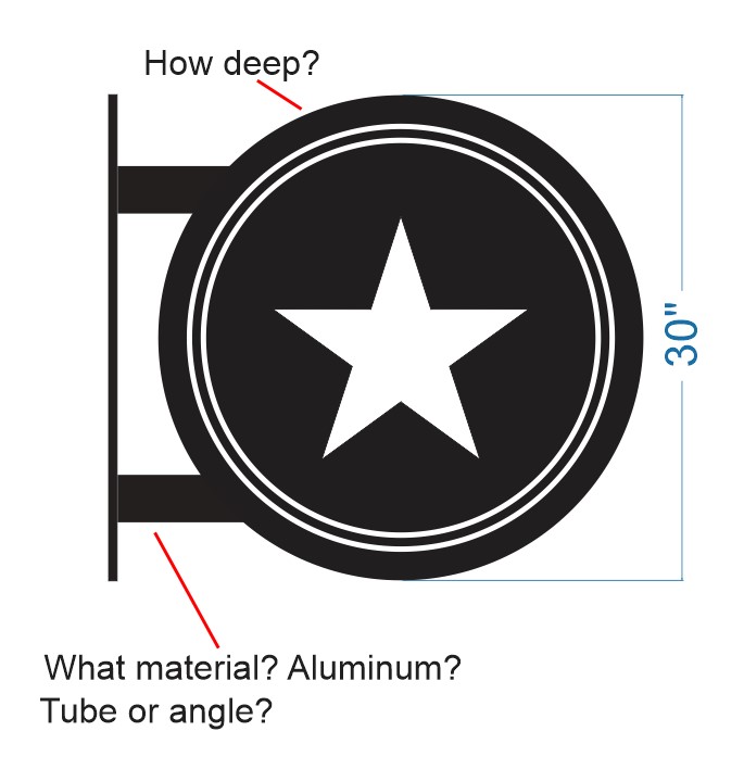

How would you fabricate a sign bracket like this one?
nolanola
https://manhattansignshop.nyc/
Hello, forum.
How would you build a bracket like in the attached file?
Tube or angle?
We want to use 6mm Max metal for the faces, and glue them to the bracket.
For the plate we would use 1/4" aluminum.
How do you usually fabricate brackets like that?
Thank you,
henryz
It's really up to you, maybe flat bar so you don't have a big gap between the 2 panels and also depends if you feel comfortable mounting the faces with tape only.
nolanola
We will use glue Weld Mount, not a tape.
TopFliteGraphics
Why not just fabricate the sign and bracket from a single piece of 1/4" aluminum plate? Then you only have to weld the flat wall mounts to the tabs.
