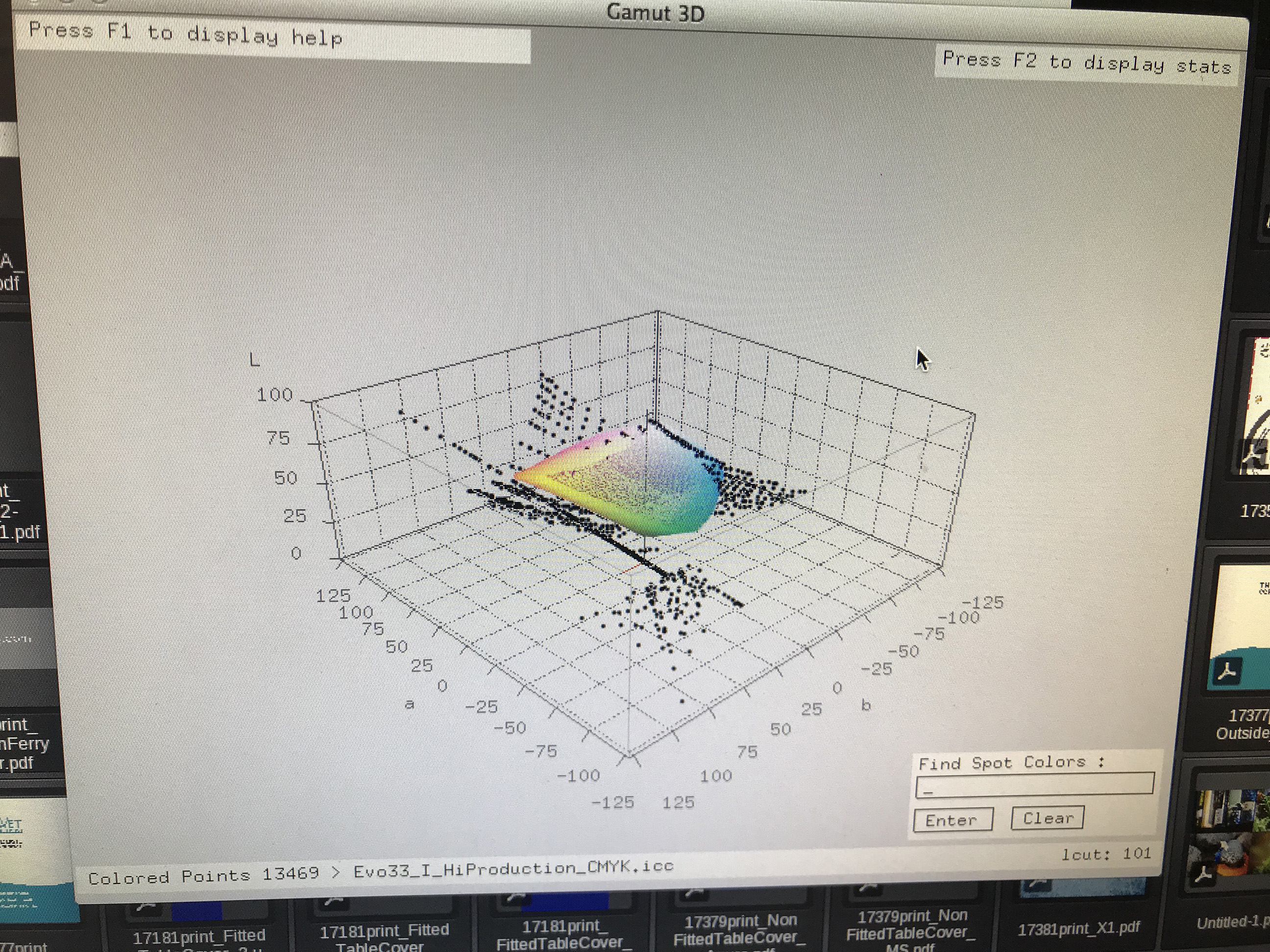

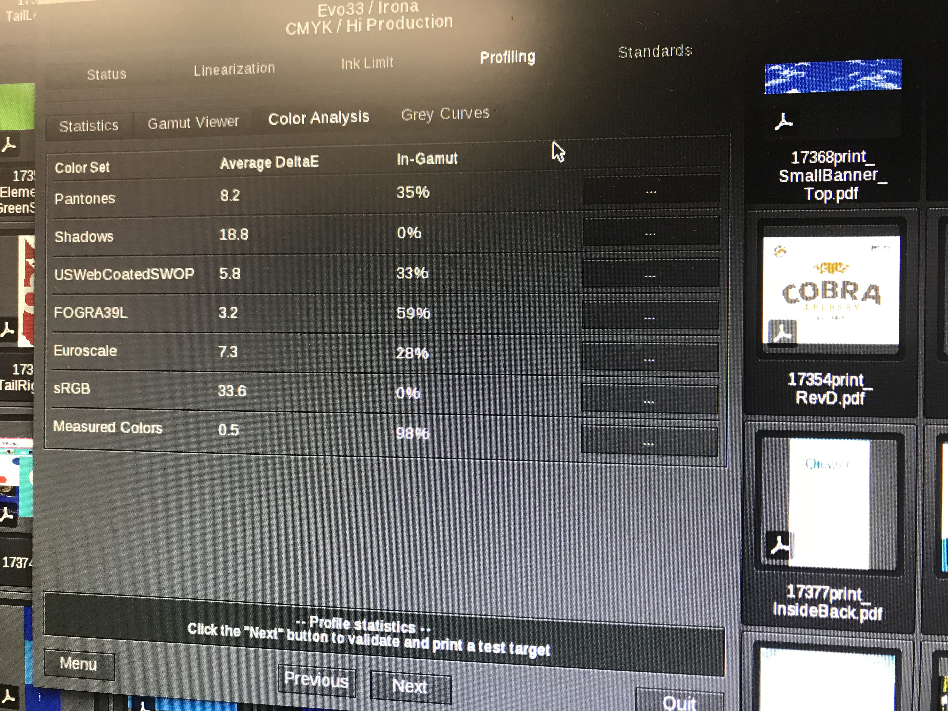

Not sure you do anything really. There is a report that will generate from the rip stating if Fogra colors are in gamut...similar to pantones.
I found this in the "easy media" module of Caldera.
There is an extended preflight module that will let me do job costing and generate reports with this same info.
It's nice for profile grading too. You can compare the gamuts of two output profiles visually.
...as you can see, my dye sub gamut is pretty weak by the numbers!
We get some nice output though!
