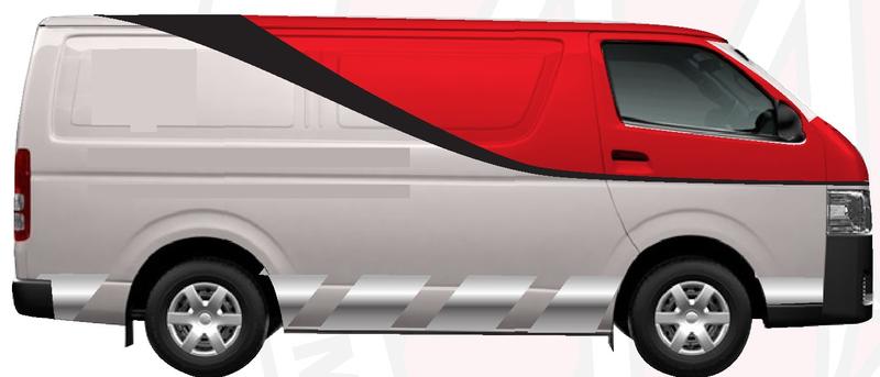

Hi all - I have the go ahead for 3 Toyota Hiace vans plus one Hilux ute/truck.
Part of the design is to wrap the top section plus the roof as per the design attached.
(I've blocked out the branding)
The vehicles will be outside all the time, so I'll be using solid color vinyl instead of printing.
(Oracal 970 RA cast wrapping vinyl). I've used this before and it works well for this type of install.
Looking at the design I'm trying to work up a best method to allow me to get the 2 layers of vinyl on.
I'm thinking I'll cut the black to shape - with say quarter inch bleed on top, put the black on first in place, then overlap the red onto the black.
But then I'd need to trim the red once it's in place. So I'm thinking putting knifeless tape in quarter inch on the black?
They are long curves and they go into recesses so not sure how well the tape would work for that?
Or maybe put masking tape along the edge of the black, then apply the red and use a knife to trim in quarter inch cutting through the red onto the masking tape, then remove the tape?
I could cut the black to shape on my large plotter, or make a template and hand cut each piece. Would probably put application paper on the black.
Don't reckon I could pre-cut the red as it may pull back a bit where it goes into the recesses leaving a gap.
Quite a few variables here. How would you tackle this odd 2 color shape with overlap??
Going around 8 sides and 4 roofs.

I could fit the black to the red first, then cut the red/black edge to shape, then install as one piece...
S'N'S
Take some exact measurements and plot the black, then lay knifless tape in 5mm and overlap red... is the way Id do it too. I have never used Oracle, is the red slightly see thru as you may have a 5mm dark red where it overlaps the black, but there isn't any way round that.
The edge of the black will act as a guide to lay the knifless tape.
joelswork
Everything seems pretty straight forward until you mentioned the recesses in the overlap area. Knife less is great but I've never used it over recesses. Put the back on, work it into the channels, put the knifeless into the channels as well, then put the front pieces on, working into the channels, then pull the tape. Should work but don't bridge the channels with the tape...too loosey goosey
