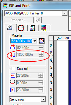

new problem. in flexi, after every 7th panel, there is a 60" blank white space inserted. aka, wasted media.. WTF!?!?

That sounds like your default roll length got reset or is too short. Could very well be something else though. I think the default sizes in Flexi are 600 inches. I have mine set as 1800 inches as the default in the machine setup in Production Manager. I've had it get reset though or using one of the default sizes that are at 600 inches and running a long job it sticks a ginormous space in between the 2 panels that land where it thinks the end of the rolls is.
perfect. thank you that was exactly the problem and your solution fixed it.
