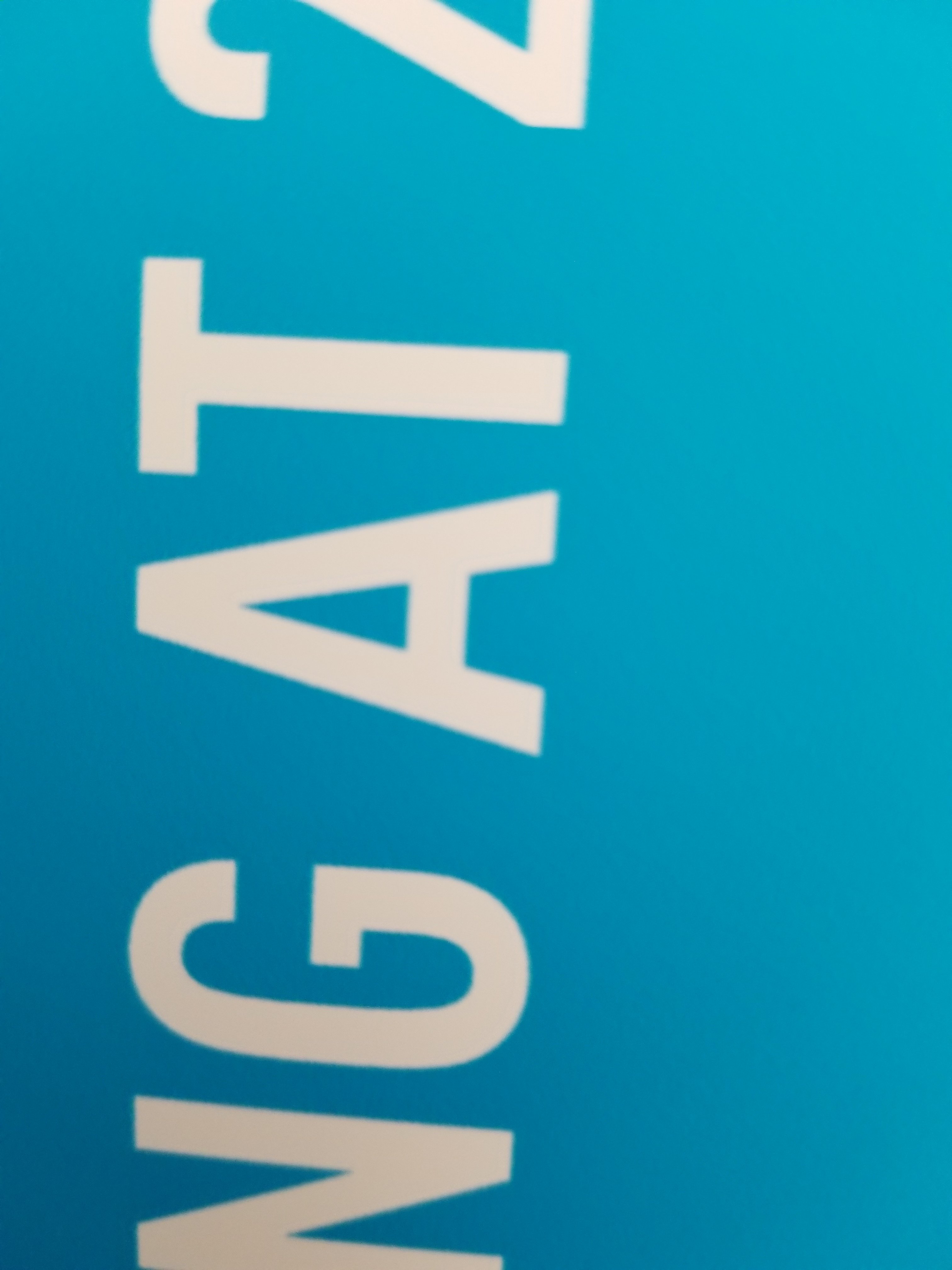

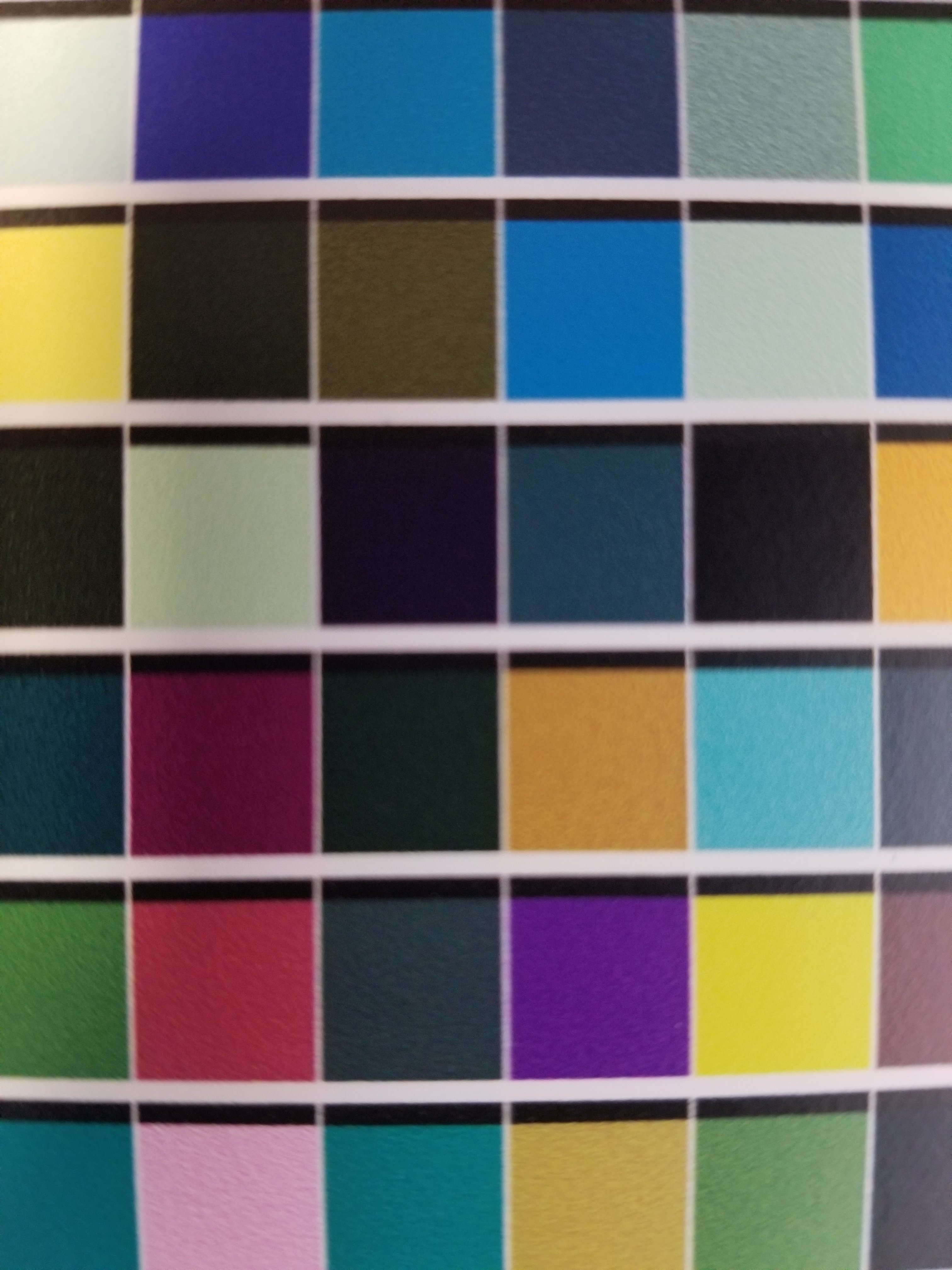

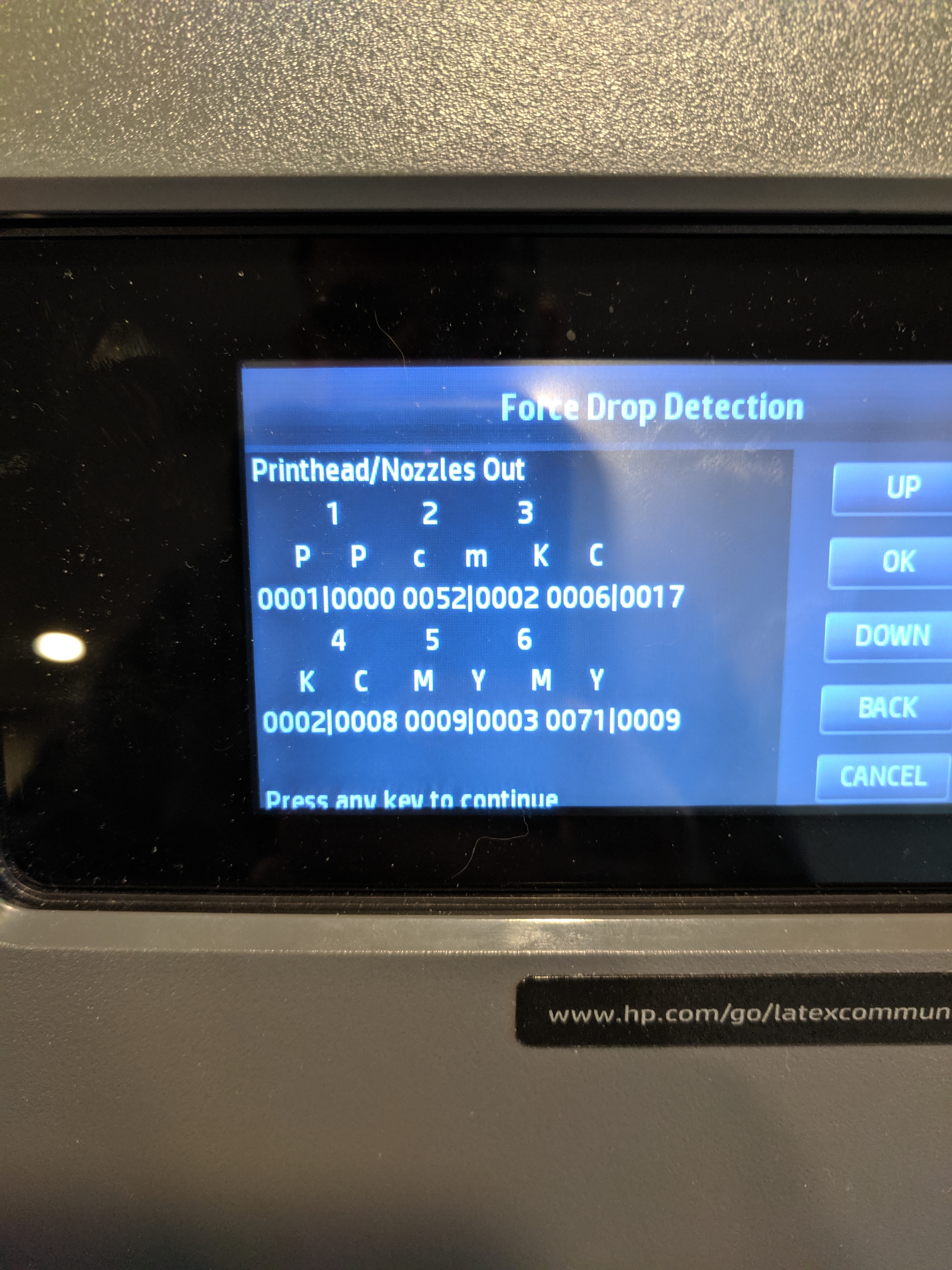

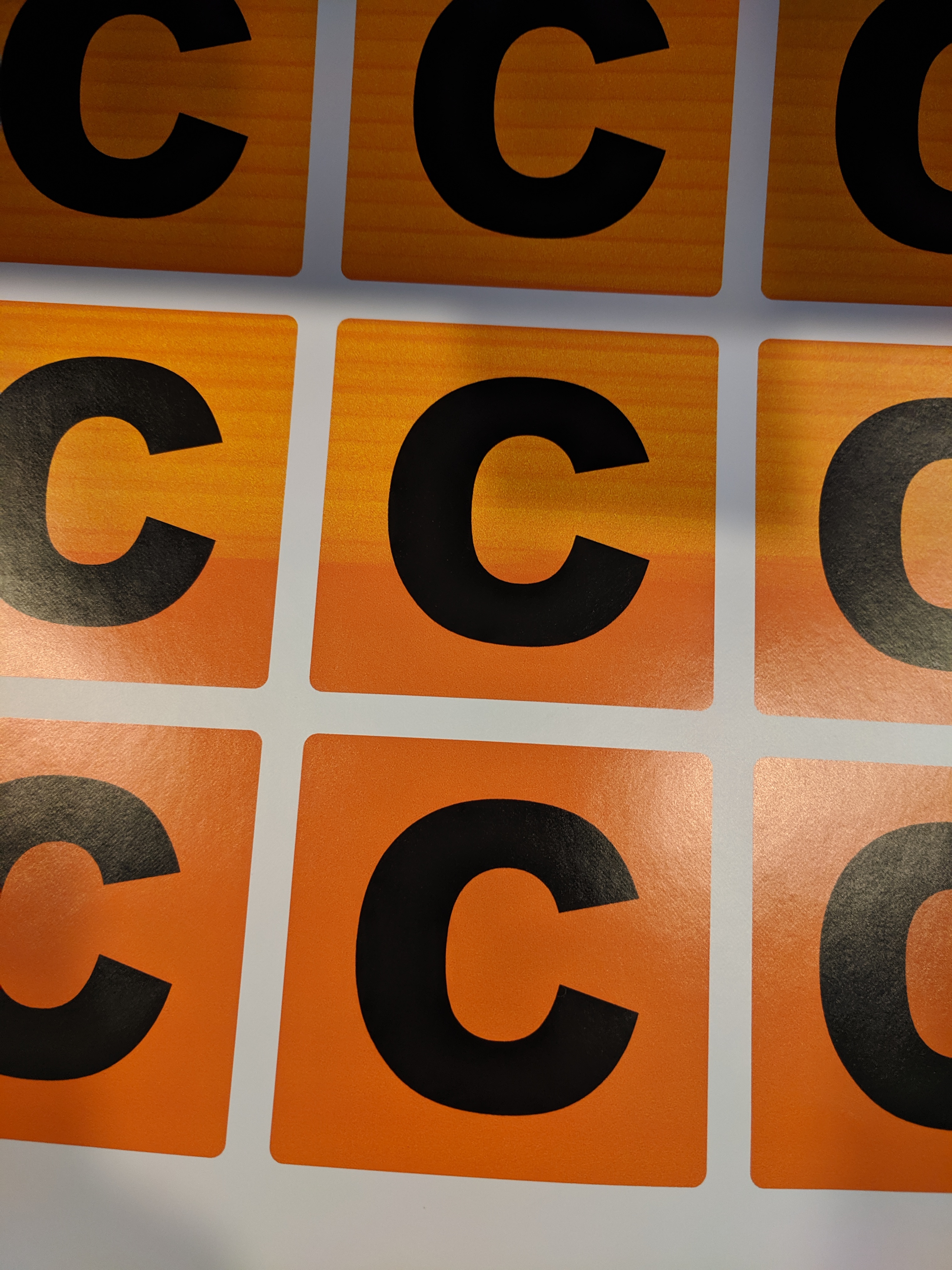

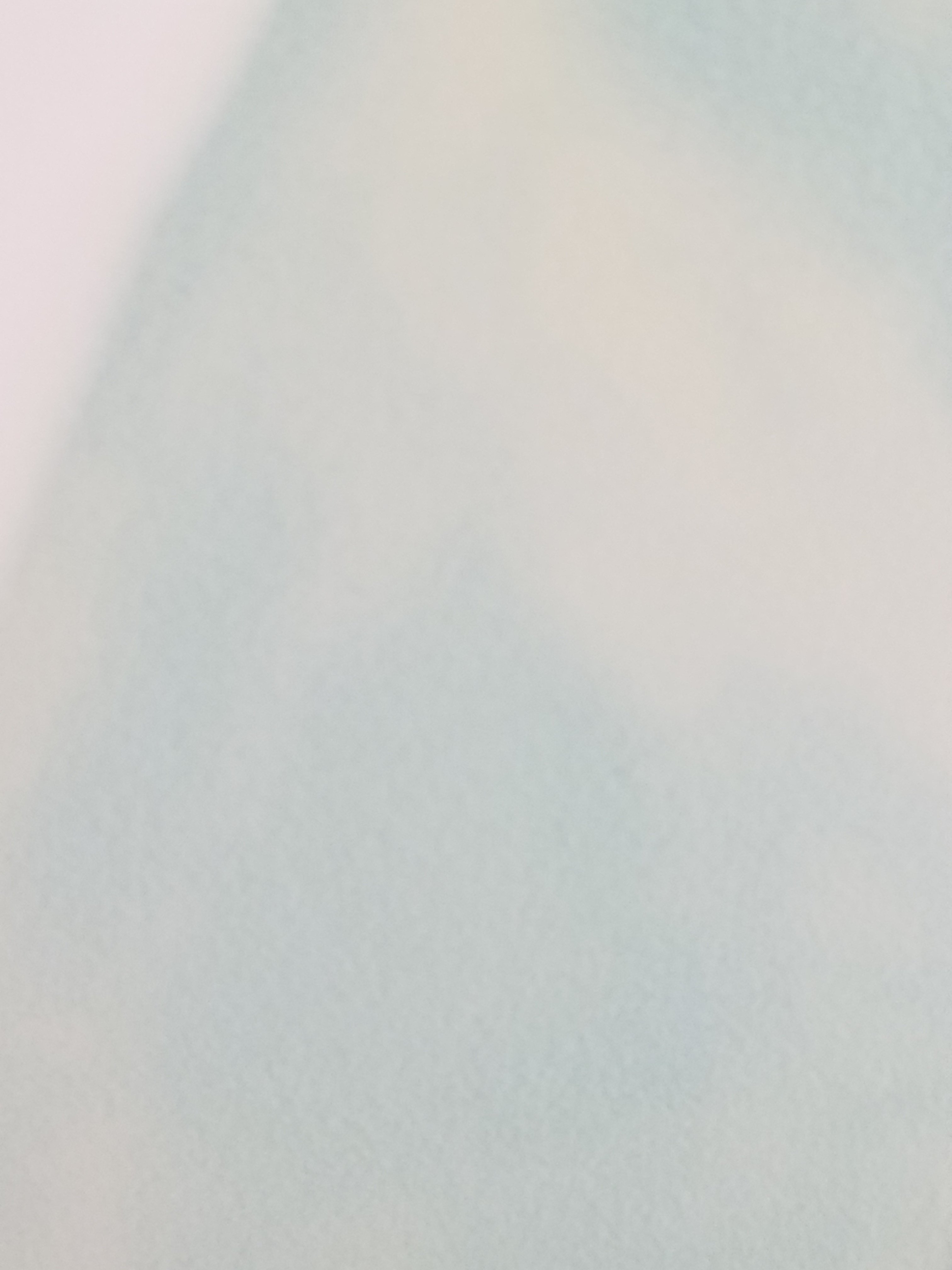

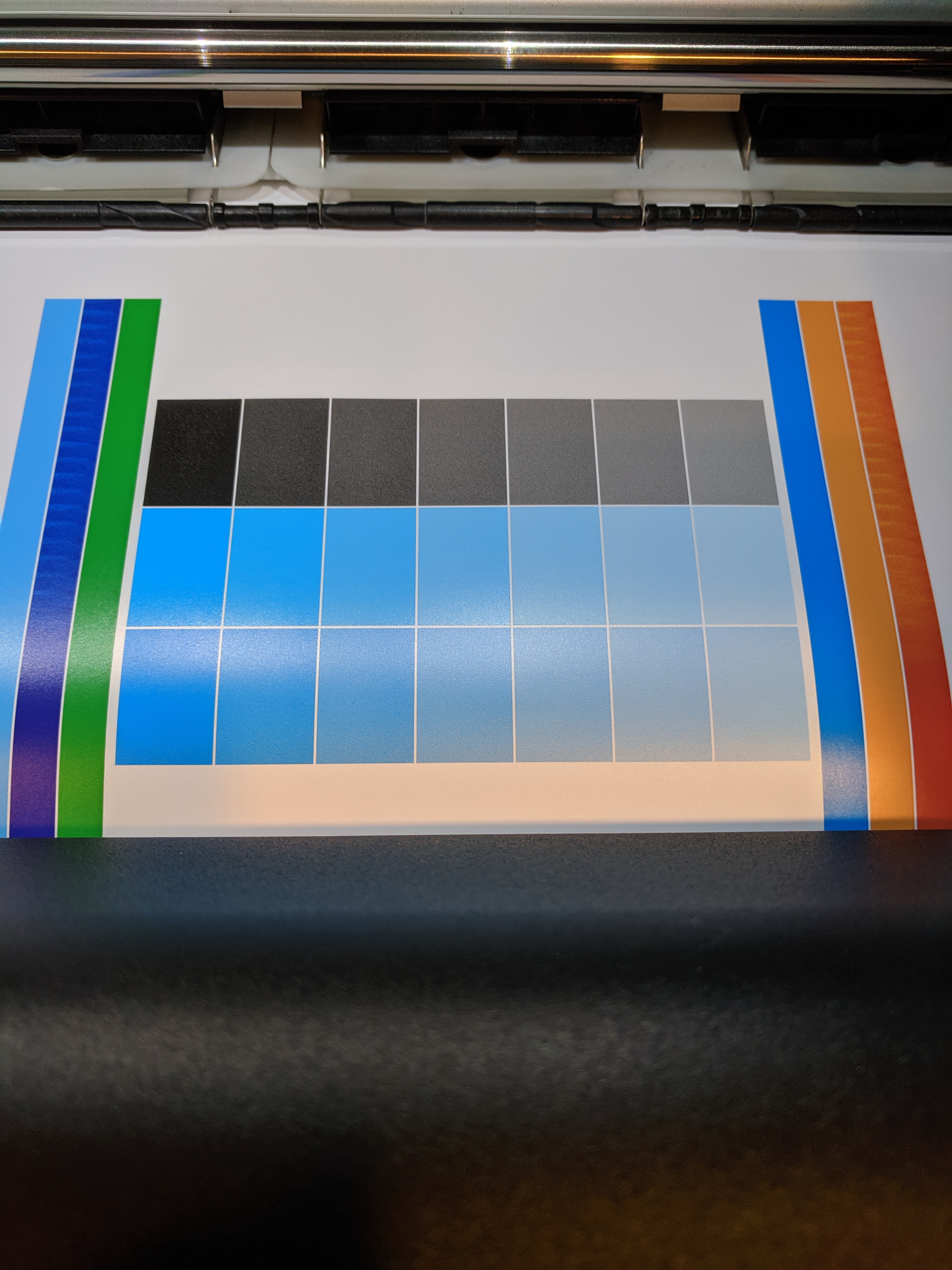

Hey All, Having a weird issue with my HP 310 Latex. I have a case open with HP, support is trying to help, but it is moving slow and at this point they don't have any answers nor making any real progress.
What happened..
- Print quality issues, banding on blues/oranges/reds, ran a drop test and my lclm head had 1k bad nozzles showing
- Ordered a new print head, replaced it, printed once, looked good
- Next day, print problems return, ran a drop test, and > 1k bad nozzles on lclm
- HP said almost impossible, but could have 2 bad print heads in a row, so they sent me new print head
- Replace it, and still having the same issue
- Replace the maintenance cartridge and the lclm print head again, and same.....issues....still.....happening
I created a CMYK only profile, and I am having the same issues, which leads me to believe that it isn't a lclm only print head issue, however why new lclm print heads are going bad with only a few ml of ink through them, no one knows.
I've attached a couple of pics showing the dropped nozzles as well as color calibration showing the 1st half prints fine, the 2nd half has banding/streaking.
I've tried 2 different Oracal vinyls, 2 (new rolls) of substance media, and the same issues.
So, 4 new print heads for lclm, 1 new maintenance cartridge, and 4 different rolls of vinyl, nothing has worked yet.

TomK
Have you checked to see if you have any ink or vacuum leaks?
Thank you for your suggestions!
I'm not seeing any obvious ink leaks, at least visually. No idea how to check for vacuum issues.
There are no errors on the LCD or in the all support page dump.
TrustMoore_TN
Sign & Graphics Business Consultant
Seems like the only thing you haven't changed out is the actually ink yet. It may be bad batch of ink (but two carts with bad ink seems unlikely).

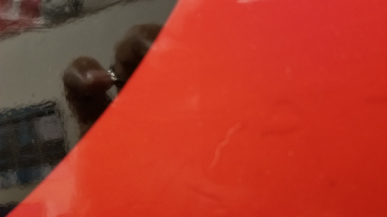

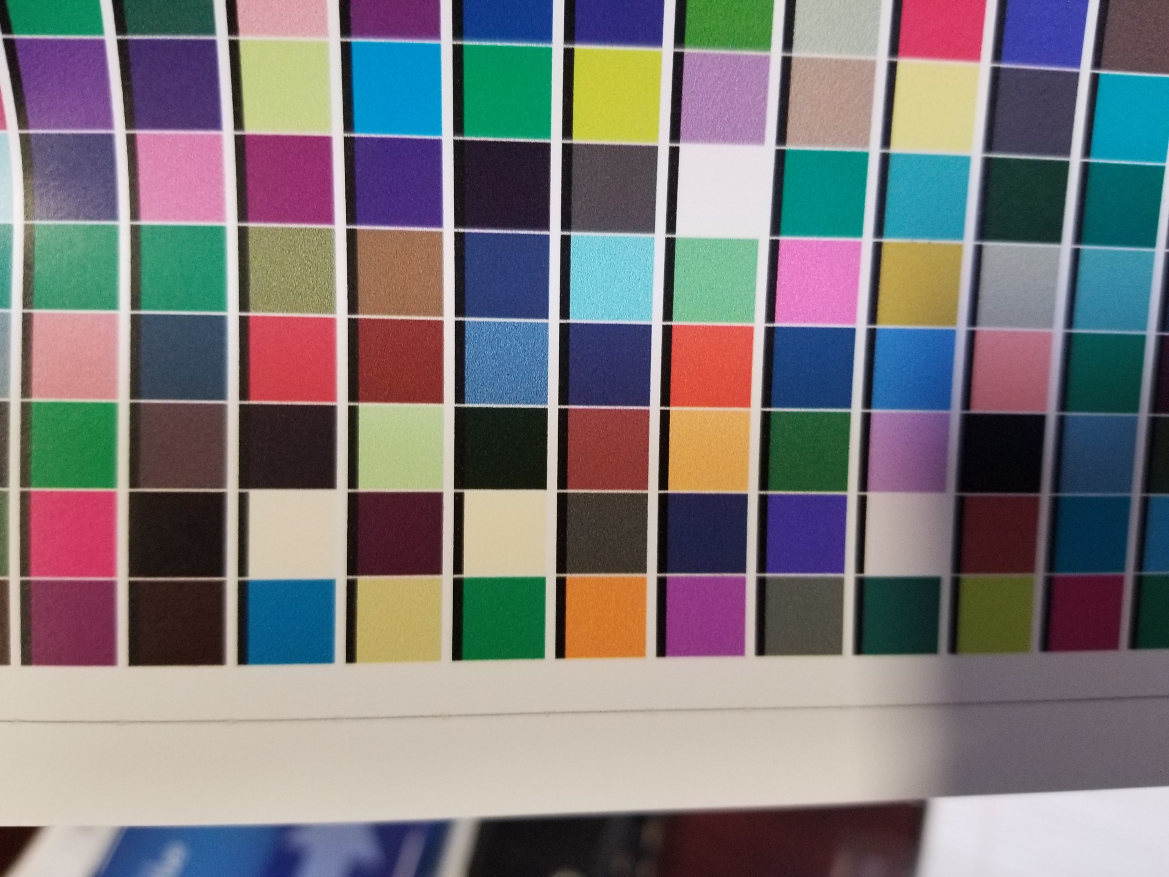

These are some of my icc profile test swatches at .25" x .25" on 6 pass
There is some graininess, but this is 6 pass, If I ran this profiling on 10+ pass it would be significantly different.

TomK
Yea, those are...grainy for sure. I'd love to see those at 10 pass or higher! :)

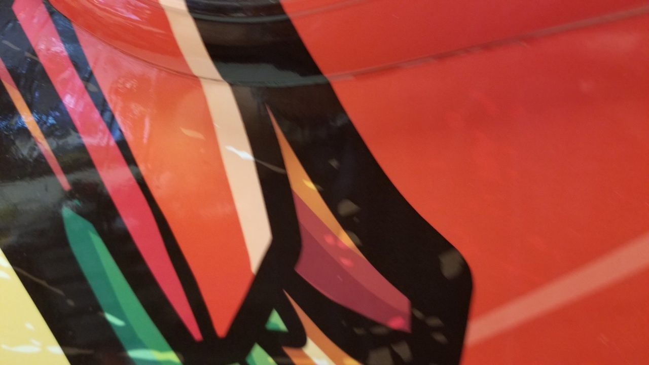

printed on latex machines, with a correct profile, in the right environment. Not grainy, 10 pass.

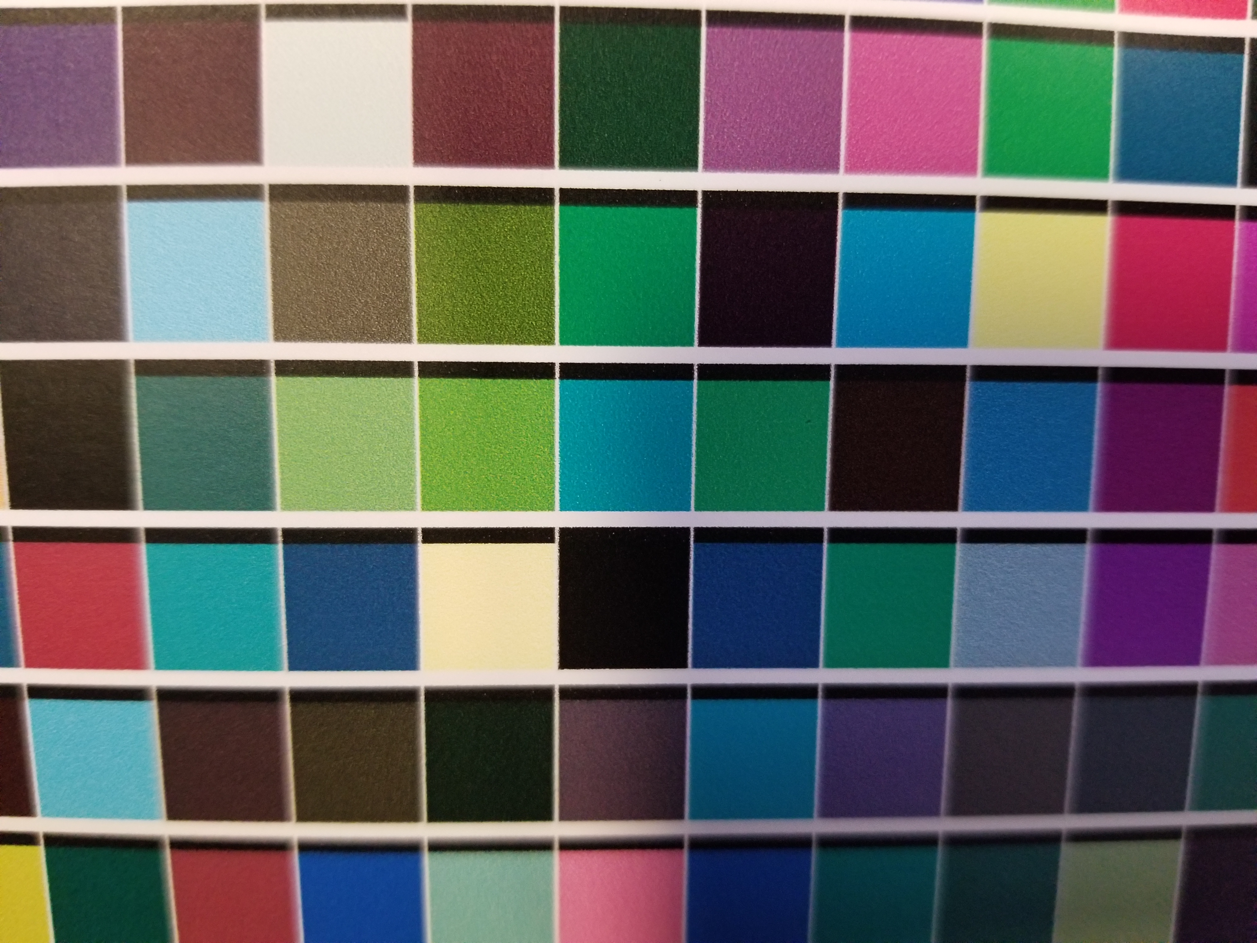

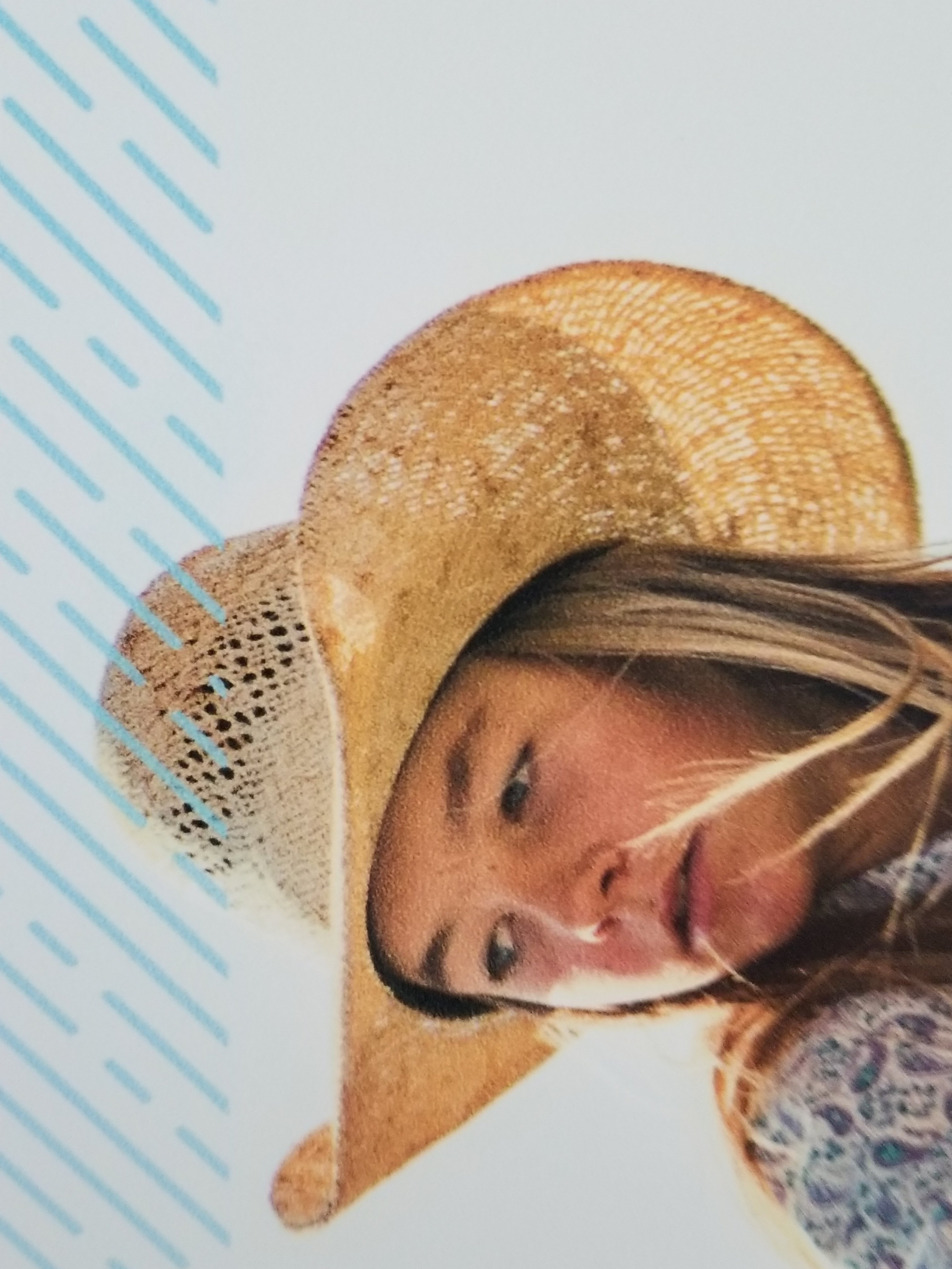

Here is 6 pass after profiling on Magnetic stock, The Source image for the Girl has grain in it.
